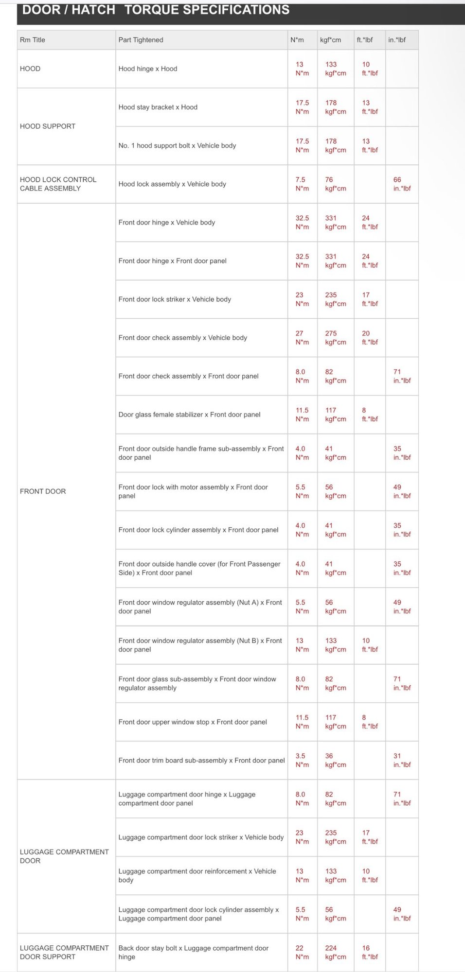

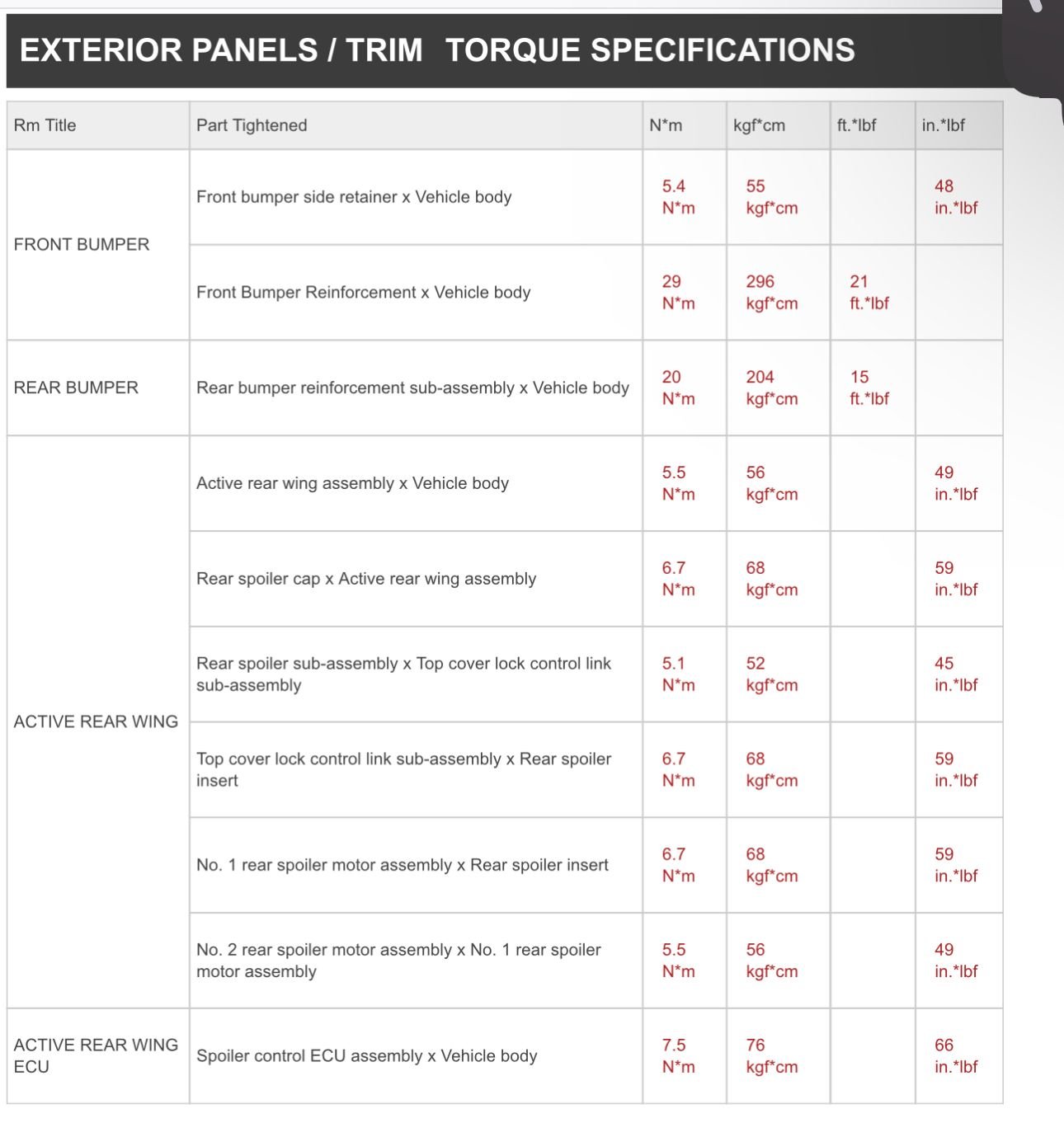

Hello everyone 😁
I'm curious if anybody knows/has a instruction with torque specs for Lexus rc/Rcf body panels, doors etc.? I've been looking on the internet but it's very hard to find
Thank you very much 😁😁

Originally Posted by Viperx
Thank you very much, this is so helpful 😁
