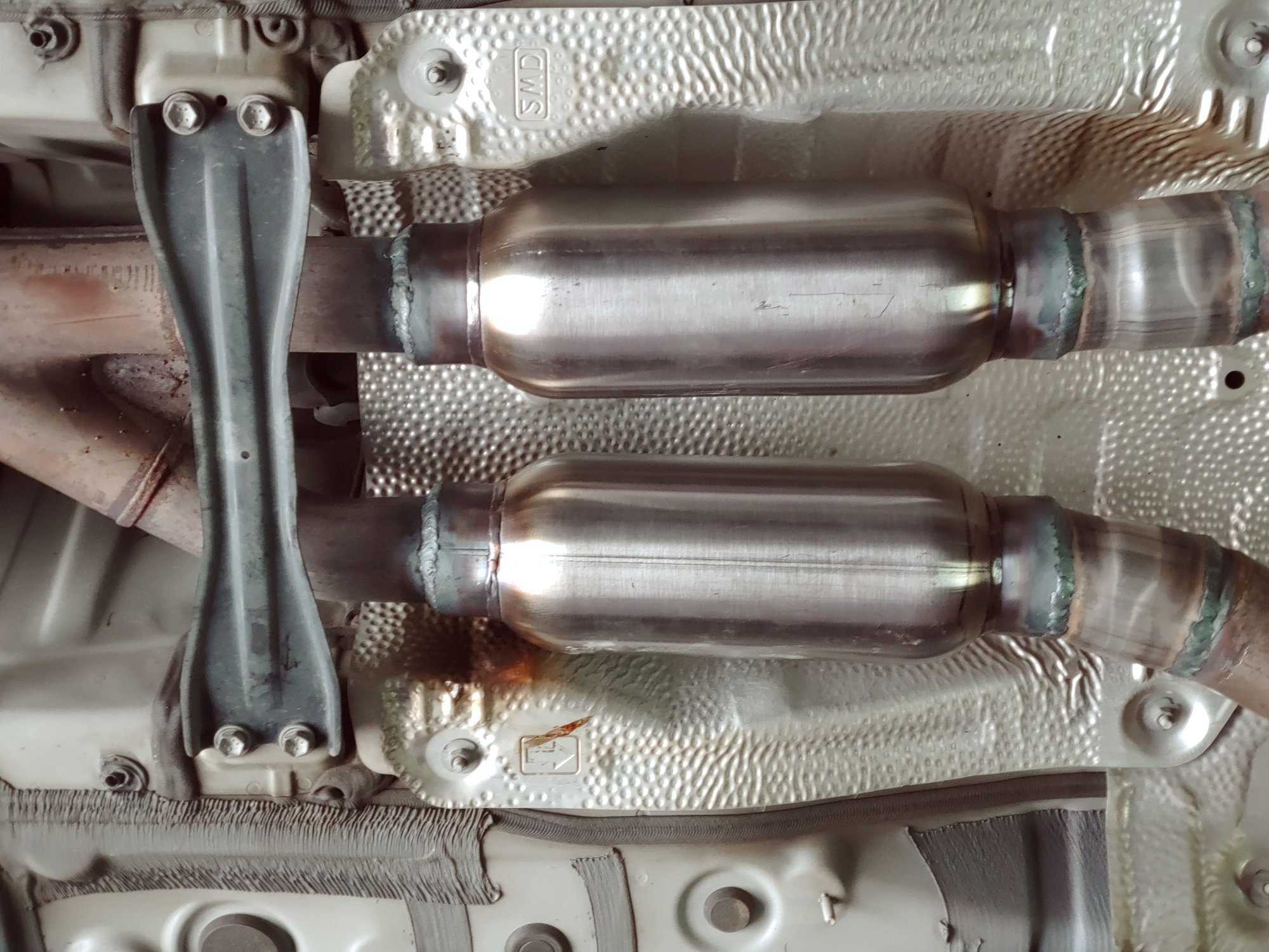

In my search for the Megan midpipe, which I gave up, ended with a custom setup.
Current mods:
F-Sport intake box mod, square hole and removed the carbon filter
PPE headers
RR-Racing tune
Yonaka axleback
15" 2.5 Aero resonator (replaced stock resonator)
two 12" 2.5 ebay resonators
two 12" 2.5 resonators
From two 12" resonators, replaced secondary cats, two in one, to the 15" resonator
I, same as the shop welder, were shocked it was quieter than before when it had the secondary cats.
Although is free flowing all the way back, is quieter, minimum drone, which I do miss. Maybe is just me, but the engine feels it revs easier, passing cars is effortless with less throttle input. Lets see if in the next few days the resonators are past their break-in and sound a little louder, if not, am going to remove the main one for a straight pipe.
There were so many threads about Megan midpipe, etc, stating the exhaust got a little louder, I thought it was going to be similar effects. The shop welder insisted to forget about the two 12" resonators and go straight pipe, but the consensus on the internet was a raspy exhaust, which I did not want. Am leaning toward removing the main resonator, the 15" 2.5, and/or replace with a much smaller one.

I liked the engine noise (drone) inside the cabin, I have a hearing condition which the drone helped to mask.
Later in the day, gave a ride to some of my friends, and they like the new setup, and stated it sounds better from outside the vehicle. We were at a fast food and when I turned the car on, they said it had a peculiar noise and could easily tell it was my car from a distance.
The resonators seem to finally break-in, as the exhaust sounds has a deeper mean tone. With the windows down, it is evident the exhaust note, but with windows up, almost none. From 2.5k to about 4k, passing rev range, has a peculiar woosh noise underneath the headers and back. The top end is more free flow, I need to pay attention to stay under highway speed limit.
I bought 2.5" resonators, he had to use spacers to adapt to the car as it is 2.25 on the outlet, is not that difficult, but something you need to know.
The inlet is easy as it is 2.5, plus the secondaries have a weird angle, something the shop may struggle on when adapting them. It really should be 2.25", but that specific seller does not have them.

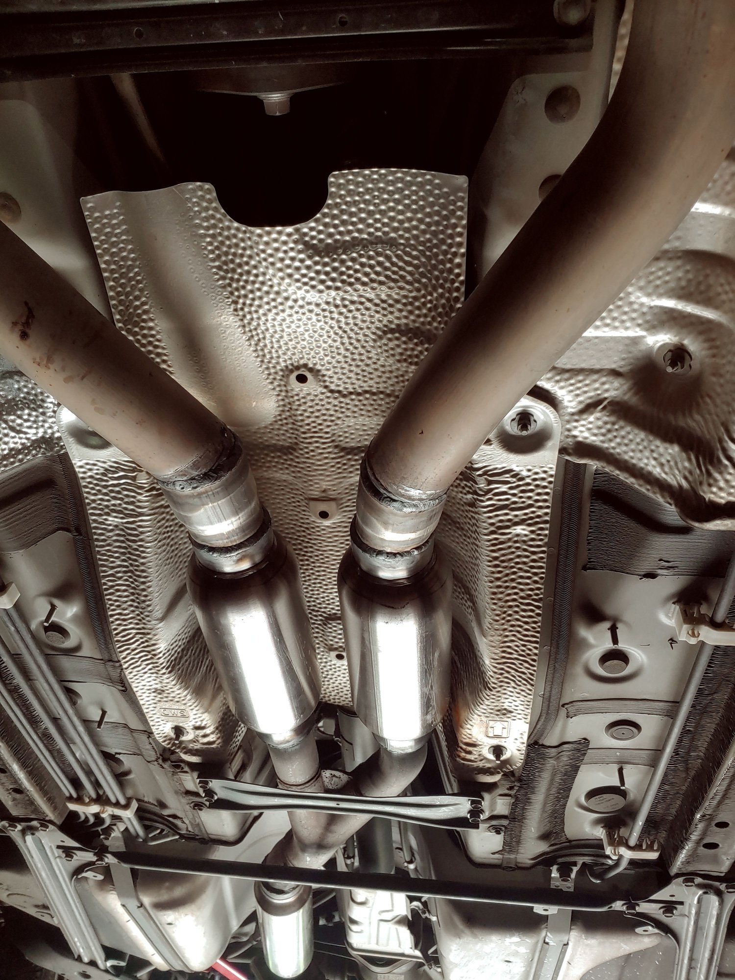

In stock trim is only one resonator, close to 2.25" inside diameter, aftermarket OD bullet shape seems smaller, it is wider ID, 2.50".
I would say it is more linear because the ebay resonators in the midpipe resolved the low end torque gap. Before there used to be somewhat of a lag, dead zone on the low rev range, not anymore. I used to throttle search the powerband, now is there, slight pressure to the pedal.
Inside of stock resonator, looks to have an opening at the center of the pipe run.
Right around 2.25ish...
