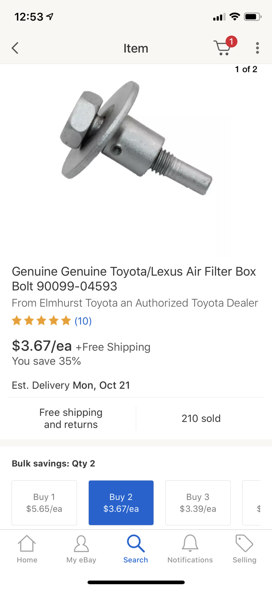

I’m trying to put my stock intake back, but the bottom air box is missing two bolts that hold in place at the bottom. Does anyone know if these are the right bolts? I have a 2014 IS 350.

looks similar if its the 2 bolts that are 10mm that i think you are talking about
your best bet is to find 2 bolts without this piece but with washers:
i would just drop by your local Auto Parts store for this, if it doesn't fit, in and out vs. waiting in the mail for bolts

This is the part number for the bolt: 90119-06953
It does differ from the one you posted as indicated by the green circle from Greysheart.
The bolt you found is an airbox bolt, just not the correct style for the one you have.
The correct bolt can be had at any Toyota or Lexus dealer.
