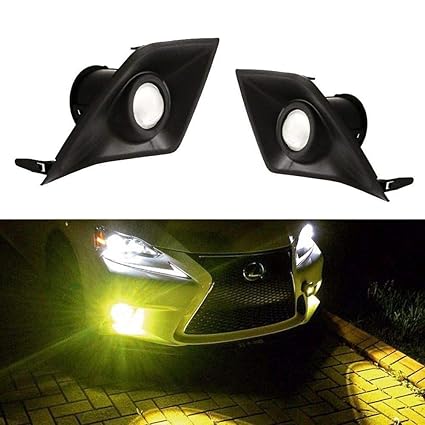

Use an aftermarket short ram with a heat shield, like such
Then, replace the passenger fog light cover (My F sport doesnt have fog lights so its not a loss) with an aftermarket fog light just for the template
next, remove the fog light and run some sort of tubing from the fog light hole to into the heat shield for the short ram (image just to give an idea of the type of tubing)

Not sure what compromise he would be making by buying fog lights for a car that DOESNT come with them, and using them to make a cold air duct...
