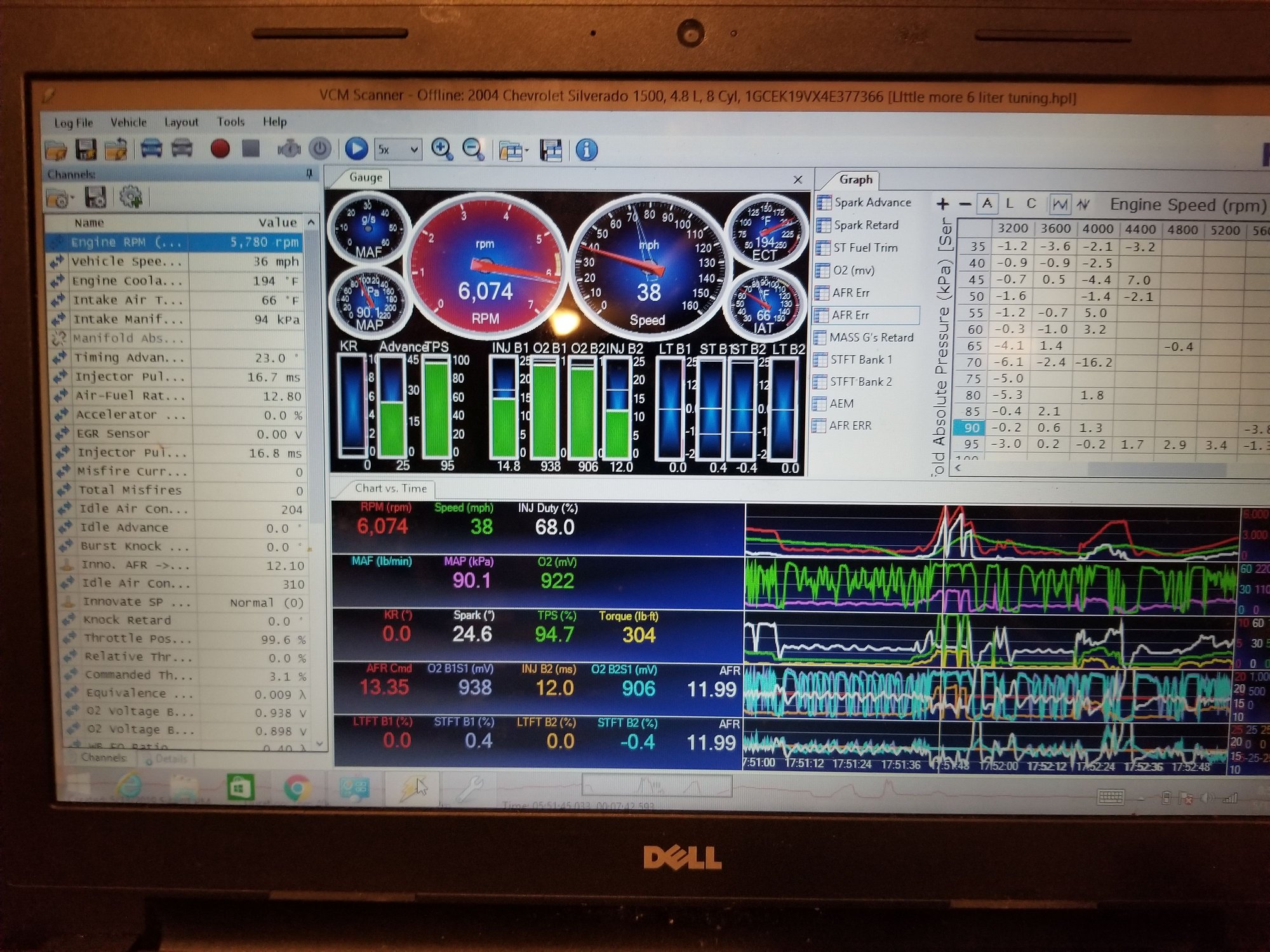

No, i haven't reeeally gotten it tuned correctly yet. I went to get on the highway after a little cruise, stabbed the throttle, and the car went in limp mode, no throttle...
It does this every time i go full throttle
So i gotta put more time into it. Good news, the ABS works! So my tone rings must be welded on straight enough. That's nice.

After some research, i believe i was exceeding the limit of my ve table, making the pcm think it was achieving some crazy high number of airflow. The cause is running bad injector data, or more specifically, trying to make up for my lack of fuel pressure with jacking up the ve table.
This GS runs 50 psi, the 2001 was always 55psi. It's enough to make a difference, when you lose 5lbs of fuel and feed an engine that's 1.2 liters bigger on the same old 4.8 tune.....
Got my ve table back to a stock tune, and re calculated my injector data to match the lower fuel pressure. Bam, short term trims are much less crazy and at least in the driveway i can't make the throttle issue happen. With the last tune, it would consistently kill the throttle just free revving it with a stab.
Basically, i reset the tune and started over. Should be a much easier process now. FYI you're not supposed to exceed 100 or so in your VE table!

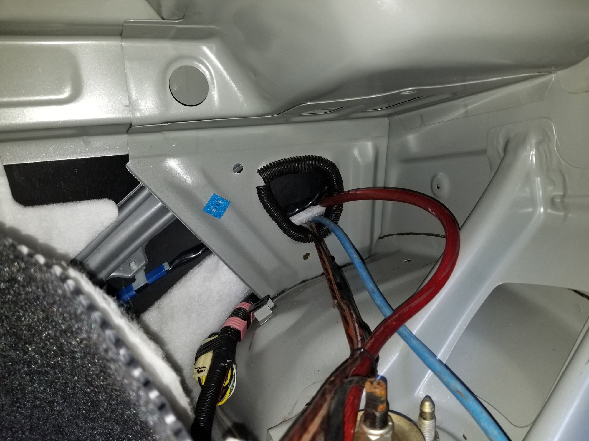

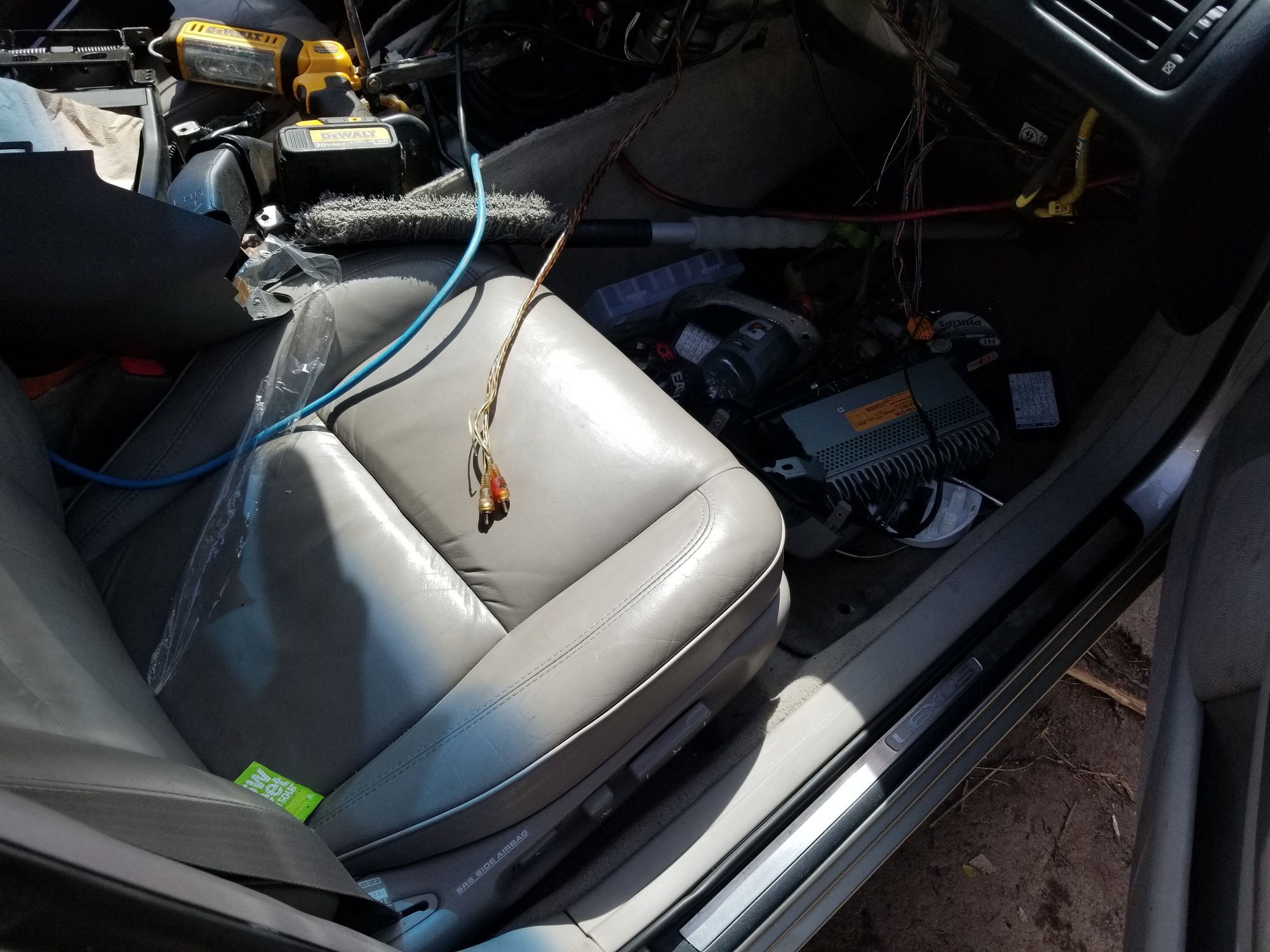

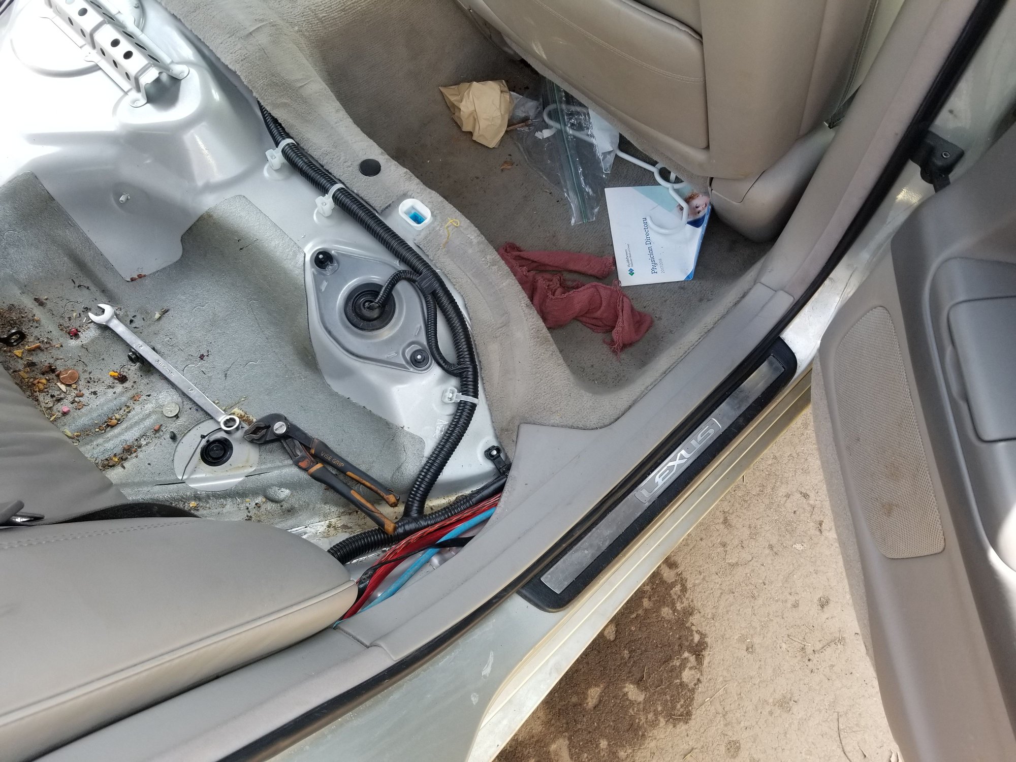

Getting my wiring ran for subs and cutouts. Next up, wideband. No need for the factory amp that takes up so much room!

Getting there on tuning. I got the wideband in and went for a spin, floored it only to immediately back off it. WOT was trying run about 15afr! Can't be running it like that...
So last few days I've been tuning VE and again had to scale my injector data "smaller" to avoid maxing out the ve table causing the throttle issue. Much safer now, WOT is around 12.5 and gets fat towards redline. Still gotta trim it up.
POWER! This thing is an animal... The 4.8 was like a Honda Vtec. No power until 4k rpm. But this 6 liter, jesus, from 2500- redline is just smooth strong power.
Super nice power band down low to help move this fat pig. It's much more civilized than before, i can lug this thing at 1000rpm in town, i can idle up and down my driveway or in parking lots.... I'm just loving having my car back.
