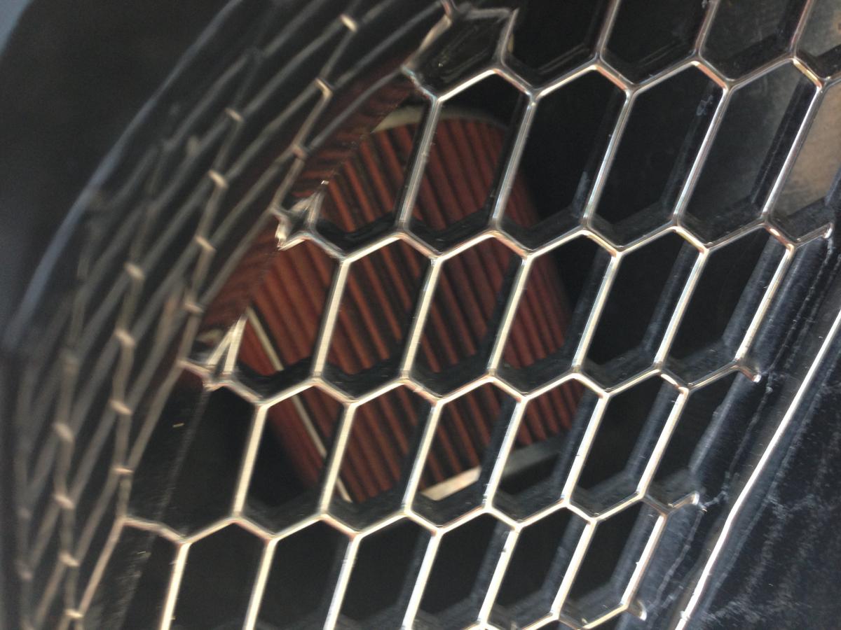

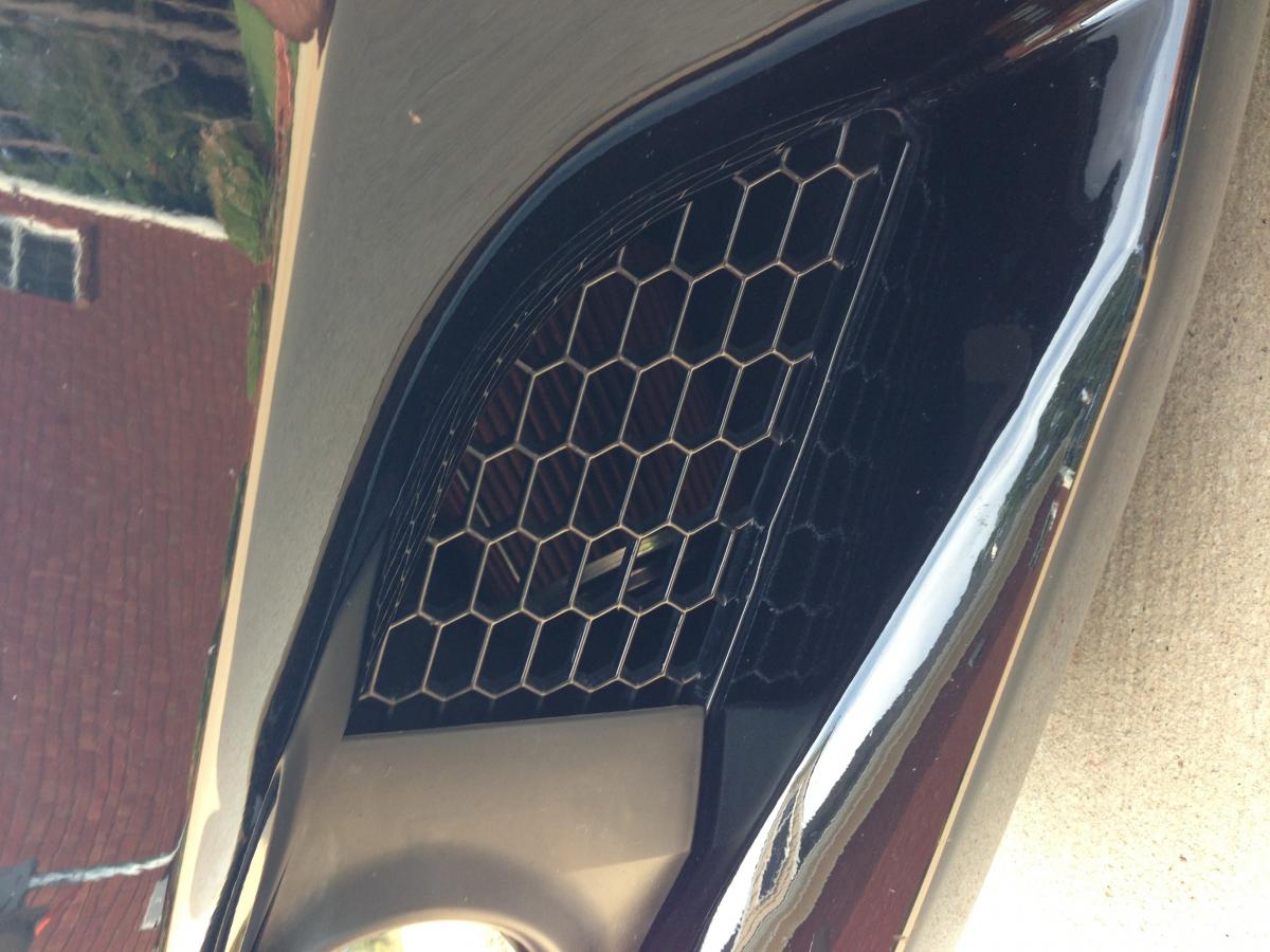

^Can you not provide us a picture of it through the engine bay?

Pix of it is all we need. Take picture of it from engine bay and outside.

How do i add a pic from my iphone to this message board
Old Jul 29, 2013 | 03:25 PM
andy350's Avatar
andy350
Joined: Jun 2013
Posts: 374
Here are the pics
Old Jul 29, 2013 | 03:27 PM
andy350's Avatar
andy350
Joined: Jun 2013
Posts: 374
More pics...hope it works
