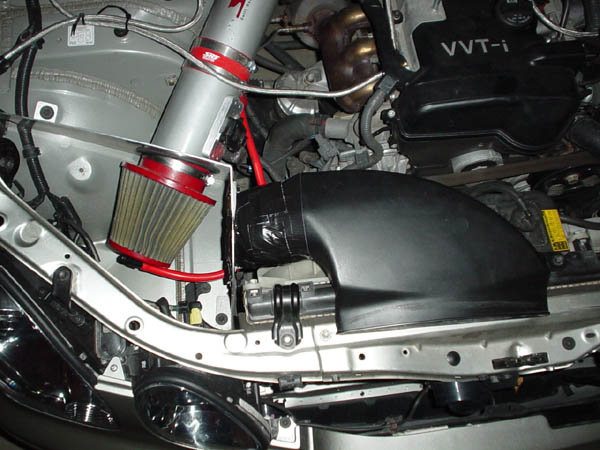

I need help
After I did little mod to my srt intake, engine check light came on after about 20 miles of driving so I reset the ecu with pulling negative term. of the battery to make sure. the light went off for awhile then it came back on. I did this about 3 times with same results. Can someone plz help? I have attached the picture of mod. thanks

What "little mod" are you talking about?

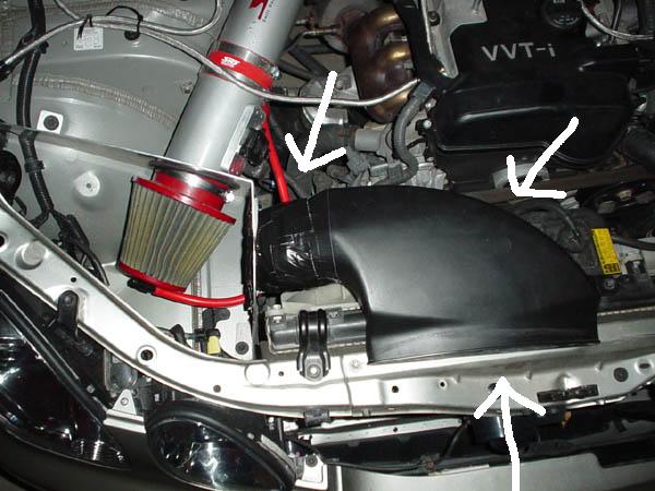

This one...

For the 300 you can't have cold air blowing directly onto the air filter this was the reason why MO never put the Air Director shield for the GS300 the ECU is different....it will work for the IS300 though...
You have to remove the air director and cover up the hole you made that's the only way you're going to get rid of the check engine light...

someone else made a similar mod on their 400 last year with the same results. The reason for the light has to do with airflow velocity disruption across the mass airflow sensor. With the air fluctuating, the MAF sensor sends an unstable signal to the ECU.
