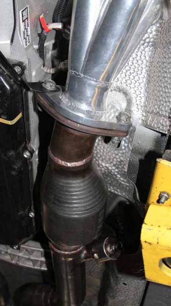

Originally Posted by montgb
Hi flow cats are unneccessary. Get them if you are concerned about passing emissions inspections in your state.
I disagree, get them if your concerned about the environment. I have PPEs on my F and it would never pass visual inspection because the cats are not stock, but it will pass the sniffer Also, vehicles without cats tend to smell of unburned fuel.
Lou
