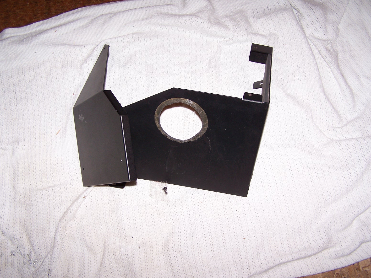

Out of the box there is no way to attach the factory scoop to the SRT heat shield. Using a 4 1/2" hole saw and a 4" silicone coupler this is what I came up with (still need to trim the coupler a bit).
Adding the factory scoop back in has lowered the intake temp 10-20 degrees. Putting the intake temp 1-2 degrees above ambient (when the car is moving).

how did you measure the temps?
Old Jun 8, 2011 | 12:02 AM
DeanGS's Avatar
DeanGS
iTrader: (8)
Joined: Nov 2009
Posts: 159
Scanner, factory IAT sensor.

something similar to this? i just bought this box from a old member (it was made for a gs430 with a SRT intake)
Old Jun 8, 2011 | 12:59 PM
DeanGS's Avatar
DeanGS
iTrader: (8)
Joined: Nov 2009
Posts: 159
Very similar but I want to utilize the stock air scoop as well.
Did somewhat enclosing the filter bring the noise level down at all?

that enclosed box seems like overkill. where do you get your air from? seems rather restrictive, might help with noise but it seems as if the intake would have to work harder to find air. using the factory scoop as the op did the best idea. it is similar to cai system. op how much is the srt unit?

There is actually plenty of air from behind the headlight as the box is not completely enclosed. The factory scoop tends to pick up "cooler" air if only by a few degrees than air coming up off of the pavement, from under the car or low in the grill opening. It really doesn't make much difference, roughly 1 hp for every 10 degree temp drop in intake air but the factory scoop is there so why not....
