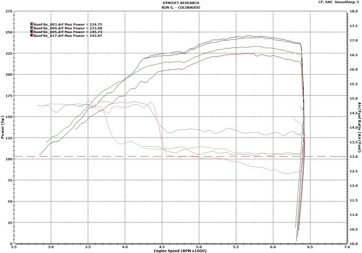

Dyno Session 01 GS430 (Borla exhaust) some interesting results
I wanted it done in 4th gear (that is the 1:1 ratio gear) but the tuner was unable keep it there w/o the tranny wanting to kick down to 3rd when accelerating hard, From another dyno I did a year ago, 4th gear was about 6-8 rwhp more than 3rd gear. My Car is stock except for a Borla Exhaust (+3rwph +7TQ from previous dyno)
Hot day 89 degrees to start.( This was done at the end of last summer)
Dyno 1-2 trying to run 4th gear- tuner settled on 3rd gear.
Dyno 3- Stock intake and filter-89.44 degree ( filter dirty but not overly so. 15k miles @2 ½ yrs on filter) rwhp-225.3 twtq-241.3 a/f 13-12.5
Dyno 4- Brand new K&N drop in filter-90.12 degree. A/F slightly leaner. I did not plan dynoing this, it was an after thought to throw this in. and WOW Before everyone runs and get a K&N The big question is how much of the big jump was merely from putting in a cleaner filter?? I have seen many dyno’s where big gains (or getting back what was lost) have come from just putting in a clean filter and replacing old spark plugs. I wish I had a new stock filter to compare and know for sure but I didn’t.
I know K&N drop in are good but I don’t believe that good so I‘ll give it the benefit of doubt and say 50% was form the K&N and 50% from cleaner filter, unless someone has more info. on this. Rwhp 233.4 rwtq 256.8 a/f 13.5-13
Dyno 5-SRT/race ECU installed-89.87degree Look how lean the A/F went. Rwhp 245.95 rwtq 270.25 a/f 14-14.5
Dyno 17 (runs 6 to 16 tuner trying to get A/F back near 13) - SRT intake w/ S-AFC- 94.5 degree – Engine getting heat soaked. No improvement from SRT ECU handling the A/F. I believe the 4 1/2 degree increase had a major effect on the dyno #’s I tried to give it 5-10minutes to cool down but it did not drop fast enough.
Now that I have S-AFC tuned ( I kind of think it is tuned a little lean) the tuner says the A/F is where it should be. Rwhp 244.2 rwtq 269.2 a/f 13.5-13

a/f ratio
HP-A/F
TQ-A/F

BTW your Rwhp 244.2 rwtq 269.2 a/f 13.5-13 at 94 degrees are good figures for I/E and Neo; well, good for your altitude and those high temperatures. You would most definitely add 20-25whp and 20-25wtq if you were in 30 degree temperatures; then you would be right were my 2/2/08 dyno was (or maybe even slightly higher), so your right in-line with things. IIRC I was around the 13.2/13.3 A/F range...pretty lean I guess.
