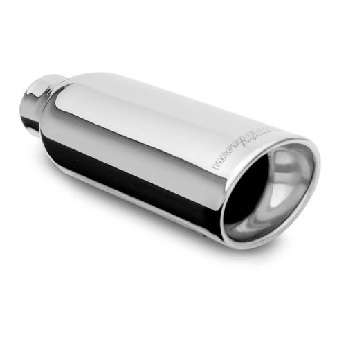

I was getting tired of scraping the ground with my exhaust tips on my Borla exhaust (Borla 11729) and decided to take advantage of the sale Amazon was having on Magnaflow products. I picked up 2 oval resonated tips model 35174 and put them in place of the carbon fiber tips on the rear. While the car was in the air, I had him replace the small muffler after the cats and y with a straight pipe. The shop only charged me $70 for everything and did an awesome job. I couldn't be happier with sound! I'll try to post a sound clip after work. Here are the pictures...

Maintain PM'd me the following questions and I felt others may want to know as well so I hope he will not mind my answering here:
"I remember reading one of your exhaust post about x-pipes where you stated that the stock system functions as one big x-pipe and is very well engineered. With that statement, I concluded that it would be unnecessary for me to remove most of the stock exhaust just to put in a smaller x-pipe and run all new pipe to the back and lose low end power. Removing that small resonator made more sense to me since it seems most people (including me) do exhaust mods to gain more sound seeing that power gains are negligible. Just wanted to hear your input on my thought process for this exhaust mod. "
It looks like the shop replaced your center resonator with a 2.5" pipe. The stock resonator = a perforated 2.36" pipe so the 2.5" is a good choice for an upgrade. Not sure about the transition back to the second Y pipe leading to the rear duals and the performance may not be noticeable... may just be louder and possibly create droning. What do YOU think of your change? Power? Sound? Droning?
I do recommend keeping the stock front Y pipe which you did. Removing the resonator and mufflers will obviously make the car louder and I wonder about your driving impressions? Louder usually makes a car "feel" faster but is yours any faster? Removing also reduces weight which improves power to weight ratio as long as power does not drop.
Weight is one of many good reasons to keep pipe size as small as possible as larger pipe size weighs more.

BTW, you did not post a pick of the tips before install. I like the way they look much better than your previous tips.
Old May 7, 2010 | 07:46 AM
maintrain's Avatar
maintrain
Joined: Jun 2004
Posts: 293
From: Georgia
Originally Posted by jbrady
Sounds mean! I like it.
Thanks. Find myself riding with all the windows down more since doing this. Thanks for posting the picture of the tip.
