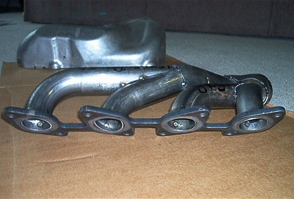

The headers add real usable power than you can actually feel to the GS400 and even more to the 430s since they have even worse factory manifolds than the 400s.
Even MORE important is the improvement in engine response and the mid range power and torque. While an improvement in peak power is great it is the mid range power than makes a street car that much more fun to drive. The power and response if everywhere in the RPM range.
For people that are really concerned about inspections: yes, they are direct bolt on parts and are designed specifically for the catalysts to be used just as stock. These were designed to fit INSIDE the stock factory heat shields. Although there are no provisions to install the shields on the S&S headers that would be a possibility for someone with a little ingenuity. I could see welding a couple of tabs to the headers that the heat shields could bolt to. If this were done it would look just like stock and never be given a second glance at inspection.
This would only work with the 400s as the shields for the 430s would not fit.
I guess you could buy some 400s shields and fit them over the headers on a 430 if you were really concerned.
Here is a picture of the prototype headers fitting inside the heat shields:
