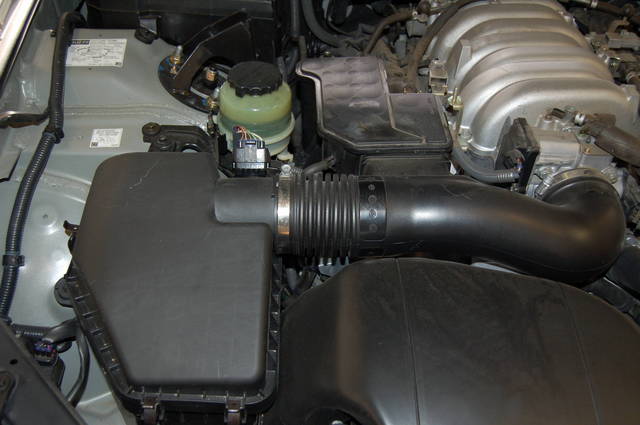

Take a look at the attached picture. The air filter goes inside of that black box to the lower left. You unclip the cover and you will see it.

It is actually different on GS3 (He has 02 GS300). You have to unclip the little top cover on intake pipe (also located in the left lower part of underhood) and slide in the filter vertically.

My bad...I did not look at his profile when I read the post . Oh well, at least now he will know if he buys a 430
