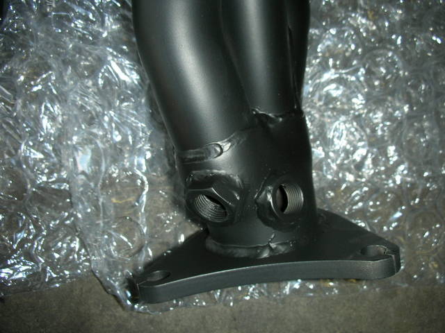

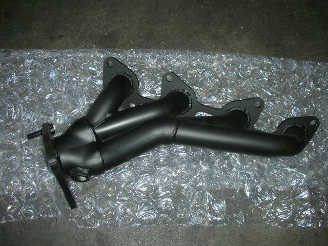

They called me so I could go down to take pics of the new headers before the install, since I had them shipped directly to the shop after being Jet Hot coated.
I am one of the few that ordered their headers without jet hot coating.
Reason being I had some other mods done to the headers.
Here's a few pics.
First off I went with the Black Jet Hot coating, for a stealth look. Need to pass visual on CA smog inspection. Didn't want the shiny silver to attract attention. Those who know the S & S headers will note that I had the seams around the tubes against the header flange welded. There was a bead on the inside, but another bead on the outside was cheap insurance to prevent leaks or cracking, especially cuz I ported the header flange openings on the inside to match up with the head.
Another mod was to add a second bung so I would be future ready to install an O2 sensor for my AF meter.
Since this is redgs4's thread, I'll save my other shots for a future post. This will include a shot of the special tool my shop used to take the bolts out a lot easier than what I have read others do.

No need for PM.
Welding flanges $20 at Midas in Fremont.
Jet hot was $241
