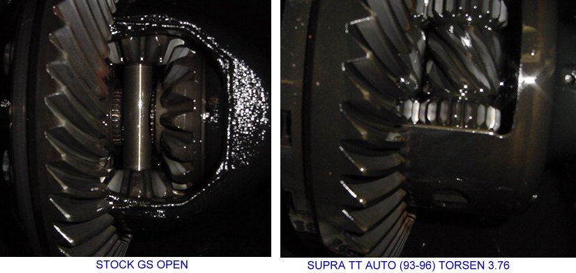

i've justcome back from the mechanic.
it is a 3.76. BUT IT HAS NO LSD.

that's a bummer man.... for sure that's no lsd...

i noticed you sold couple of units to people, however pics are pics, they can't lie. that could be a 3.76 unit but for sure not lsd. that's just an open differential. supra lsd are torsen type, and you need to have worm type gears to achieve that. i don't see that in the pics. the housing MIGHT be different, but opening up a torsen 3.76 lsd unit and i am sure it will look different.

my problem right now is that i paid for a supra 3.76 diff with an LSD. what i got clearly has no LSD. fins or no fins, it does not matter now since now i have had it opened up and confirmed 100% there is no LSD in it, which was the whole point of buying this thing.

this is a pic pearlpower on this board took of his supra lsd:
the worm gear is clearly seen in the middle. as you can see in the pic i posted of what i have, it clearly shows there is no worm gear.
