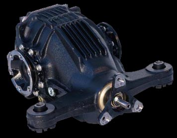

were there different casings over the years? as i was searching for info i found this pic of a new supra tt lsd:
and this is BA_GS400's unit, who bought from synco357 also:
this was taken from one of TLW's old threads:
gs diff on the left, supra lsd on the right.
they all look different... what am i missing here?

The only way to tell if it's a supra lsd is to open up the unit and look inside. Take it to a professional if you don't know what you are doing.
One of the signs that it is a stock supra lsd unit is if it has the cooling fins on the pumpkin as in TLW's picture. Unfortunately, this isn't always reliable because some previous owner could have removed the lsd like in my case. On the other hand, it gave me a great reason to buy the TRD LSD.

as you can see from the pics, the one i have has no cooling fins whatsover. it looks identical to the GS diff on the left in TLW's picture.
i'm now worried .. i've pm'd synco357 about this and i'm waiting for a response back.

wait that's NOT a lsd unit as far as i know!!!!!!!
the lsd unit has fins on the housing coz' it's a lot hotter than the normal rear end. all the supra auto rear end i have seen so far with lsd have those fins. the unit you have there doesn't....
i would be very skeptical about what you got there (unless they mysteriously changed the housing for whatever reason)
btw, yes, the gear in the pic (right one) is the worm gear

I am NOT a Supra parts expert, but, as I look at your pictures here are my thoughts.
1. your rear end CASE looks a hell of a lot like TLW's stock casing in his picture.
2. I DO think you should replace that bushing......that picture on the 2nd page of this thread is better than the first one. And as you know, you if you do one bushing, you may as well do both!
3. It's POSSIBLE that you could have a supra 'posi' (yeah, i own a chevy) inside of that case. So, don't get too worried yet. (I'm thinking of how Chevy and Ford rearends are built where the actual posi unit is interchangeable inside of the casing)
4. You should figure out what gear ratio is in there. If it were 3.23, it would have more odds of being a non-posi,....if it's 3.76 then there's a better chance it's a posi.
You can do this by counting how many "drive-shaft" rotations it takes to make one axle side turn 1 revolution.
5. I don't see the leak you're concerned about. It's not that little bit on the fins of the rear cover is it? I dont' think that's a leak,..just vapors. Perhaps it was over-filled?
6. Regarding which side is up, the rear end cover's breather should point up.
I'd like ROMINI's input on this one, but, on OTHER rearends, when you rotate one axle side, if the other end turns the opposite direction and cannot be held in position, then you've confirmed a 'posi' type of unit without removing covers or tracing numbers down. (on second thought, the verifying of a non-LSD was done with unit installed, and one wheel on the ground, hence, a lot more resistance than I can do with my hand if the unit is out of the car. Am I the only one here that old-school?)
Speaking of numbers, would there be some numbers on the outside case or inner carrier of the unit that can be tracked down in a Toyota / Lexus parts book? (or online)

Old Dec 10, 2005 | 07:21 PM
rominl's Avatar
rominl
exclusive matchup
Joined: May 2002
Posts: 81,894
Likes: 482
From: Lovely OC
sorr i made my post yesterday and then i disappeared @_@
well here's what i think, and although it's been a long time, i think i still remember correctly. please correct me though if i am wrong.
first of all let's understand what lsd we are talking about. the stock one is an open differential, meaning the car will just put the power on the wheel with least traction. that is why with the stock differential, if one wheel is up in the air, it will just keep on spinning, coz' it has no traction and is the "easiest" to spin.
the lsd in the supra auto 3.76 rear end is a torsen type lsd. torsen means "torque sensing". what it means is it sense the tq on each wheel and adjust the power accordingly. in simple terms, it basically "monitors" both wheels, if one wheel start to loose traction, the unit will "multiply" the power on the wheel with less traction and put it on the other wheel.
so that's why say on a hard right turn, your right side wheel start to loose traction (since the car roll to the left), and the unit sense the difference in traction (the right side being less) and it multiplies the tq and put it on the left wheel, helping you push through the corner.
however, what *IF* the right wheel is off the gnd? you have ZERO traction on the right. what does that mean? anything multiply by ZERO is ZERO, so you will get ZERO power on the left wheel as well. so on a car with the torsen lsd, what if one wheel is in the air? the car will NOT move. the wheel in the air will just keep on spinning and spinning and the other wheel won't even go.
so how do you deal with this situation? well simple, look at the old school big boy hummer. they have torsen type rear end and they go through some of the toughest gnd. when one of the wheel is off the gnd, they simply apply a bit of BRAKE. you start to put some "grip" on the wheel that's up in the air, and that will create some "traction" to the system, and it will multiply it and apply it to the other wheel, pushing you forward.
so with all the above "lesson", what do we know now? both the stock open differential and the supra tt auto rear end (3.76 torsen lsd), when one wheel is up in the air, you still can't tell which one is the lsd. coz' that will will spin freely. and i believe if you jack both wheels up and spin one of them, the other one will spin in the other direction (for similar reason). and in both cases, if you spin the drive shaft, the two side axle will spin in different directions too
so that's why in the previous post i said in this case, it's pretty much too hard to tell if you have an lsd unit without opening it up. another type of lsd (clutch type), i believe you can tell. the trd lsd is a clutch type. but i forgot how you tell from that already, i pay more attention on torsen coz' that's what i have.
back to your case. i am still very much in doubt to be honest. i talked to someone, he said the supra tt 3.76 lsd unit gets much hotter than the normal one, that's why it's quite a bit bigger AND heavier, and it has the fins to help dissipating heat.
good luck to you, definitely try to open it up and confirm. like i said, i am not 100% on the outside appearance, i am just talking from what i know
