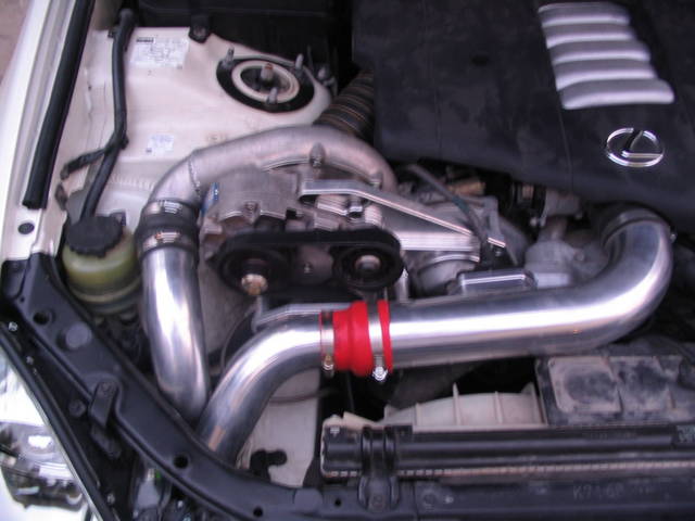

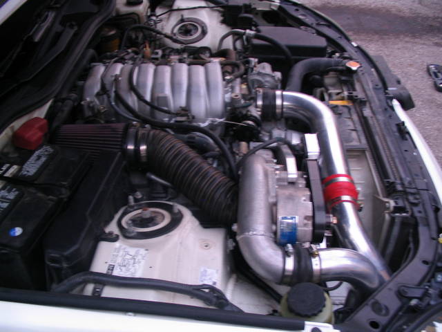

Here is the SC with cover on
SC cover off
Side shot showing the filter location
One more of filter location (me not like)

oh man, the hosing/filter should be curling back down underneath the blower!!

Like Dr. G said, it should curl under the charger and end up with the filter pointing forward right behind the headlight. There's just enough room for that there.
Sucking air from right above the manifold is probably not the best thing for performance.
