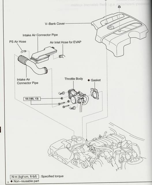

Does anyone have, or can someone tell me, the torque specs to all the bolts needed to replace a starter on a GS400?...Intake manifold, throttle body, etc.

Do you still need torque specs? I have a sevice manual I can e-mail the pages.

Do you have an e-mail address that I can send them to? I have them for the GS430, They should be the same.

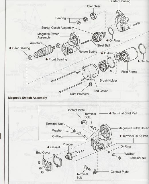

Do you want the info. from the service manual on dis-assembling, re-assembling and testing the starter also?? That is about 7-8 pages Or are your having a shop do that??

Here goes the starter in stall info. This section did not give much info on torque specs.It just referred to several different sections for more info. Like "see throttle body section or upper intake section"
If there is any particular section you need from the manual just let me know

Teh rest of the starter install.
If you need larger pics, go to my photo gallery.

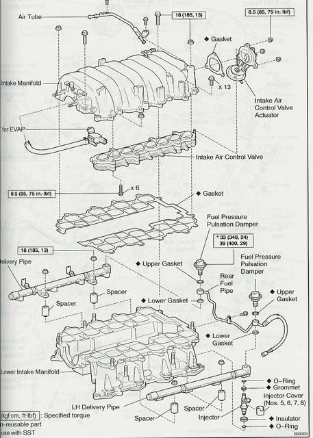

Old Dec 24, 2005 | 07:49 AM
GILLEXUS's Avatar
GILLEXUS
iTrader: (14)
Joined: Dec 2002
Posts: 1,780
From: Colorado
GSquicksilver,
Here are the rest of the pics. EM-36:

Old May 19, 2009 | 07:11 PM
Houston-GS's Avatar
Houston-GS
Joined: May 2009
Posts: 2
From: tx
These pics are a great help, but I don't see the torque specs for the intake manifold bolts. Also would like to know if the tightening sequence is specified. Thanks
