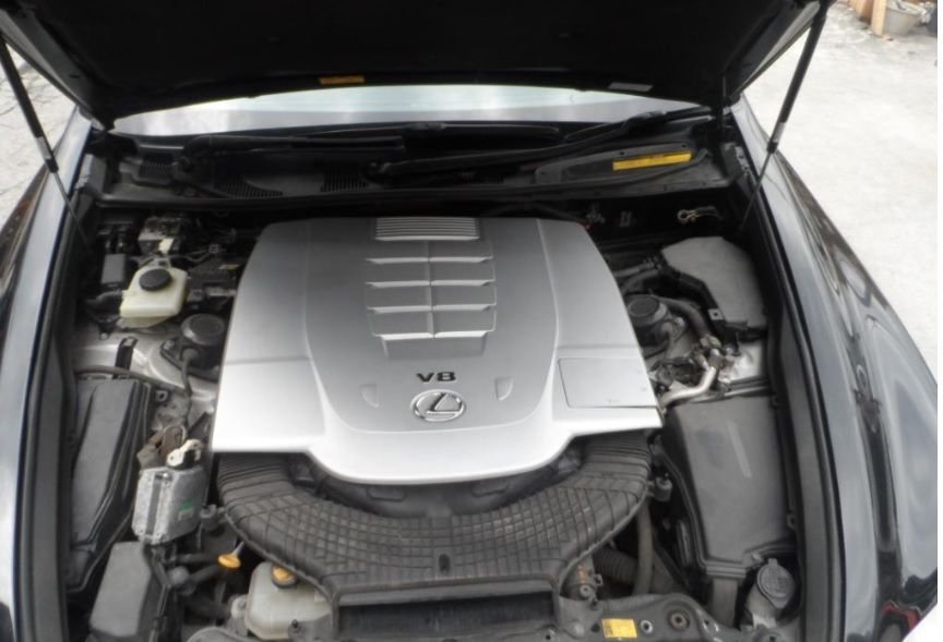

Greetings everyone, been a long time lurker and definitely learned a lot from this forum. I'm finally getting a 2009 Lexus IS250 as a project car. My initial plan is to either turbo or supercharge the 4GR-FSE, but a new opportunity arises. A friend who works in a salvage yard recently received a totaled LS460 with extensive rear damage (heard the owner spun and hit a tree but thankfully no serious injuries). The front half however is mostly intact, I have an opportunity to buy the entire front half (the LS is literally cut in half now) including the engine 1UR-FSE, 8 speed AA80E transmission, all the auxiliary (alternator, AC compressor etc), the ECU and all the harness.
I'm really tempted by this opportunity to build a poor man's IS-F.
Following are some of my thoughts and doubts :
- IS-F has a 2UR and 8 speed trans, I'd assume the engine bay and trans tunnel should have enough space to fit 1UR and its trans?
- modifications needed for engine and trans mount?
- need any modifications to the subframe? or maybe steering rack?
- IS250 rear diff probably can't survive the torque long term?
- IS350 rear diff is the easiest swap? noticed its a popular mod for LS460 guys
- do IS350 and LS460 share the same driveshaft flange?
- fueling system upgrade? high flow in-tank pump?
My biggest question
- does any of the LS460 harness works / compatible with IS250?
- for example the gear shifter? the instrument cluster? A/C systems?
- I'd try to avoid splicing and messing with the original harness (either of the car or the engine side) unless absolutely necessary.
I noticed 1UR isn't nearly as popular swap for IS250 as UZ swaps, mostly because of the electronics and the 1UR being a lot more sophisticated. So do you guys think its a possible swap? Would the complete harness and electronics from the donor car help? Or should I just stick to the 4GR? Thanks in advance, cheers!

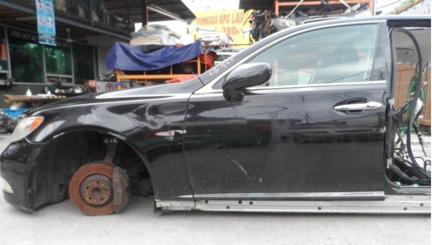

For more context, this is what I meant by I have the opportunity to buy the front half of the car. It literally is front half of the car, engine, transmission, interior, suspension, brakes. This is why it is such a tempting project for me. All these for roughly US$2000
