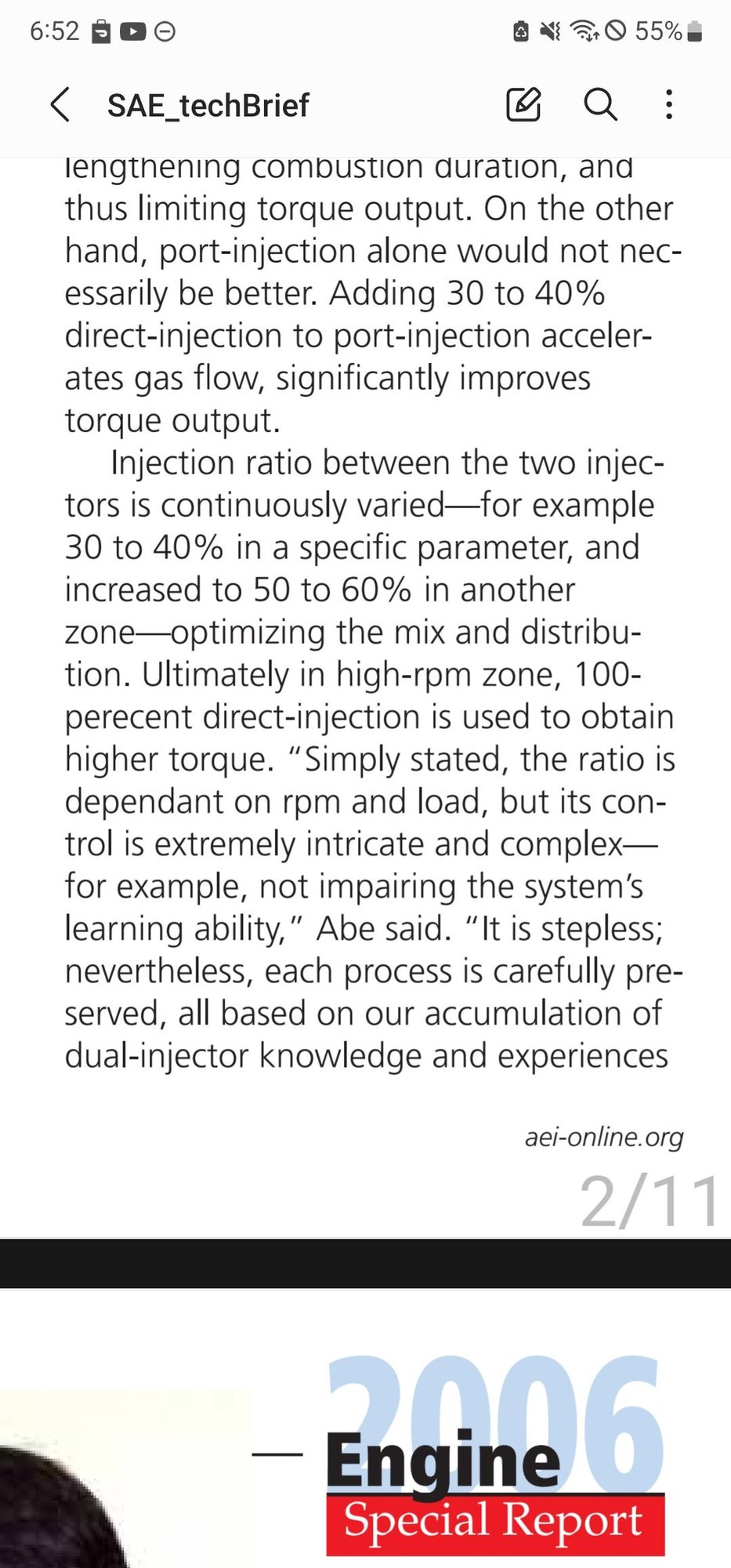

Would you mind sharing your source that says it's using port injection when at a high rpm under load on a wot pull? Because from my knowledge of how D4s works it's the opposite. Here's a few sources I've come across.
http://m.australiancar.reviews/2GR-FSE-engine.php
https://www.toyotanation.com/threads.../post-14629147

Found a post redspencer shared and it states in high rpm 100% direct injection is used
Not trying to fight a battle to be "right", but just trying to pinpoint what is actually going on with my car. Hell I hope I'm wrong and you can provide a source that shows it's port injection at high rpms, because I'd rather have something wrong with my port injection system than my direct injection system

The articles are correct and my recall is wrong. Just saying that when watching my car, the PI duty cycle is often higher than DI under load but the two are constantly on the move as is the HPFP PSI. I've seen that as low 800 and high 3800 PSI.

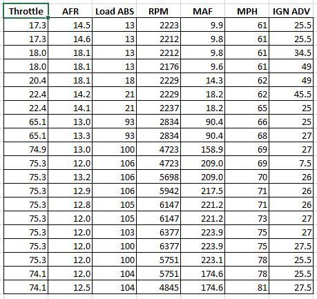

Yours appears to be hitting 11.9:1 AFR which is what mine does when fueling at WOT but my B1 B2 fuel trims mirror each other 99% of time. And at steady cruise, the LTFT zero out.
IMO the 4th gear load creates the most work and work being cylinder pressure loading is subject to ignition failure.
Are those Denso Plugs and Coil Packs? If not, I would start there as it's getting fuel based on your data. I was simply too lazy to go look it up.

Because both banks are fueling as shown by those 12:1 AF ratios. Could those cylinders go lean and cause a misfire under load? Absolutely. But now I need to compare my ignition advance with the stuff you posted and see if detonation is a possible factor?
If yes, it would pull back the timing and that would kill power.
Add KCLV to your Fusion gauge and give us a snapshot where it rides. It should be > 21
This is old data from 2017 but the ignition advance is in line with your numbers. Any chance those holes have a vacuum leak?
