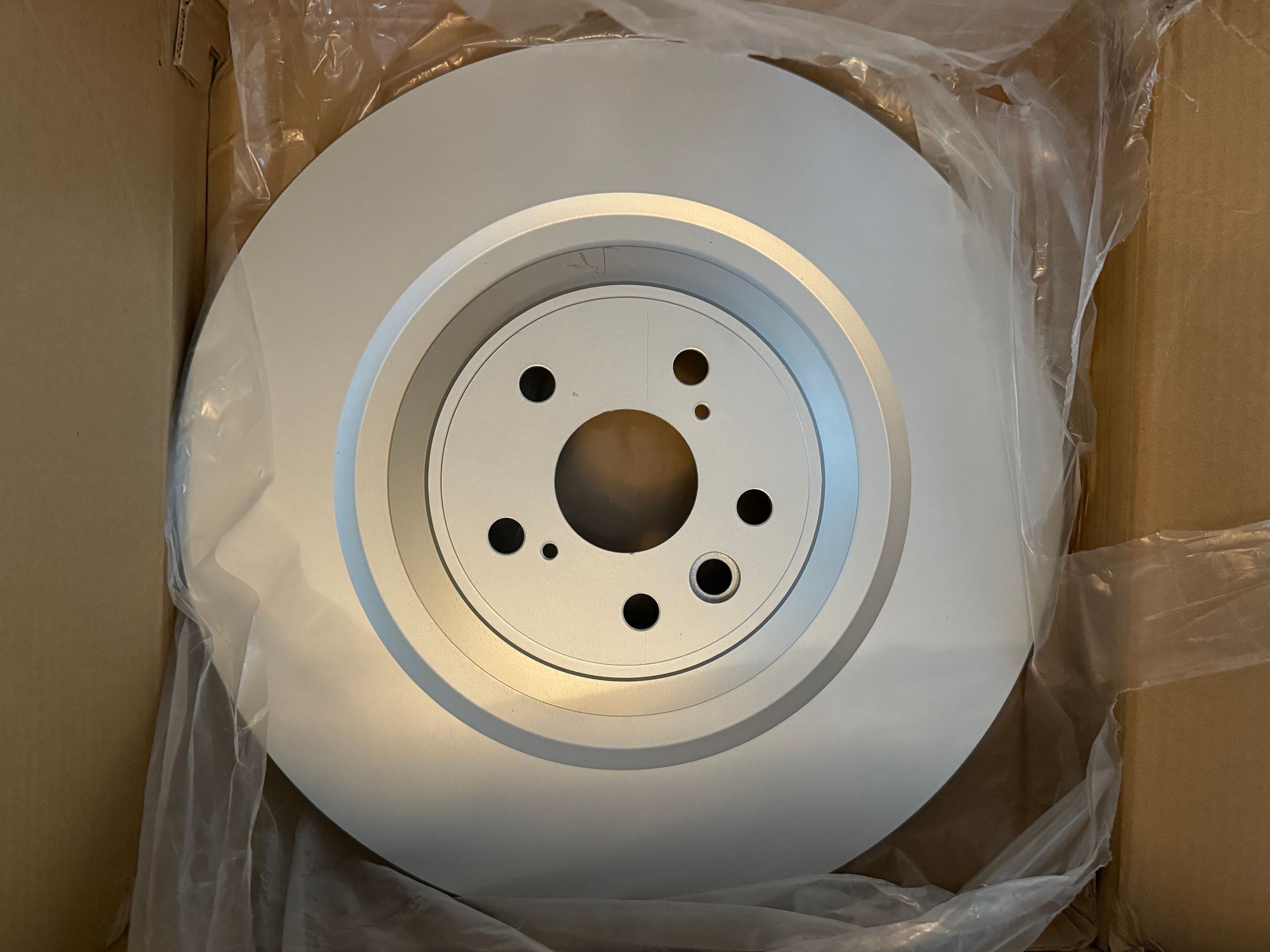

New much cheaper option for the rotors. https://www.dynamicfriction.com/sear...BqSCtmT3c9PQ==
they are available on buybrakes.com
waiting for mine to come in.
they also have the ring replacements for the oem

which ones did you get? How they lookin
I got the 1 piece coated. They don’t have the 1 pc carbon yet. They look great but heavy af.

Originally Posted by getyenz;[url=tel:11895918
11895918[/url]]I got the 1 piece coated. They don’t have the 1 pc carbon yet. They look great but heavy af.
Nice! Upload a pic when u get a chance. That site is a little funky to navigate. Appreciate ya
yeah get the part numbers off of dynamic frictions site.
looking good
