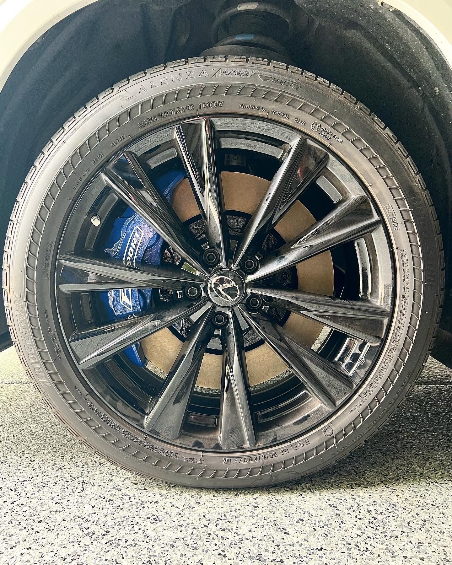

I installed the RX500h calipers on my NX350h. Install was pretty straightforward.
Reply 5

For around to my install yesterday. Coated the rotor hats to help keep them from getting too dirty.
Reply 2
