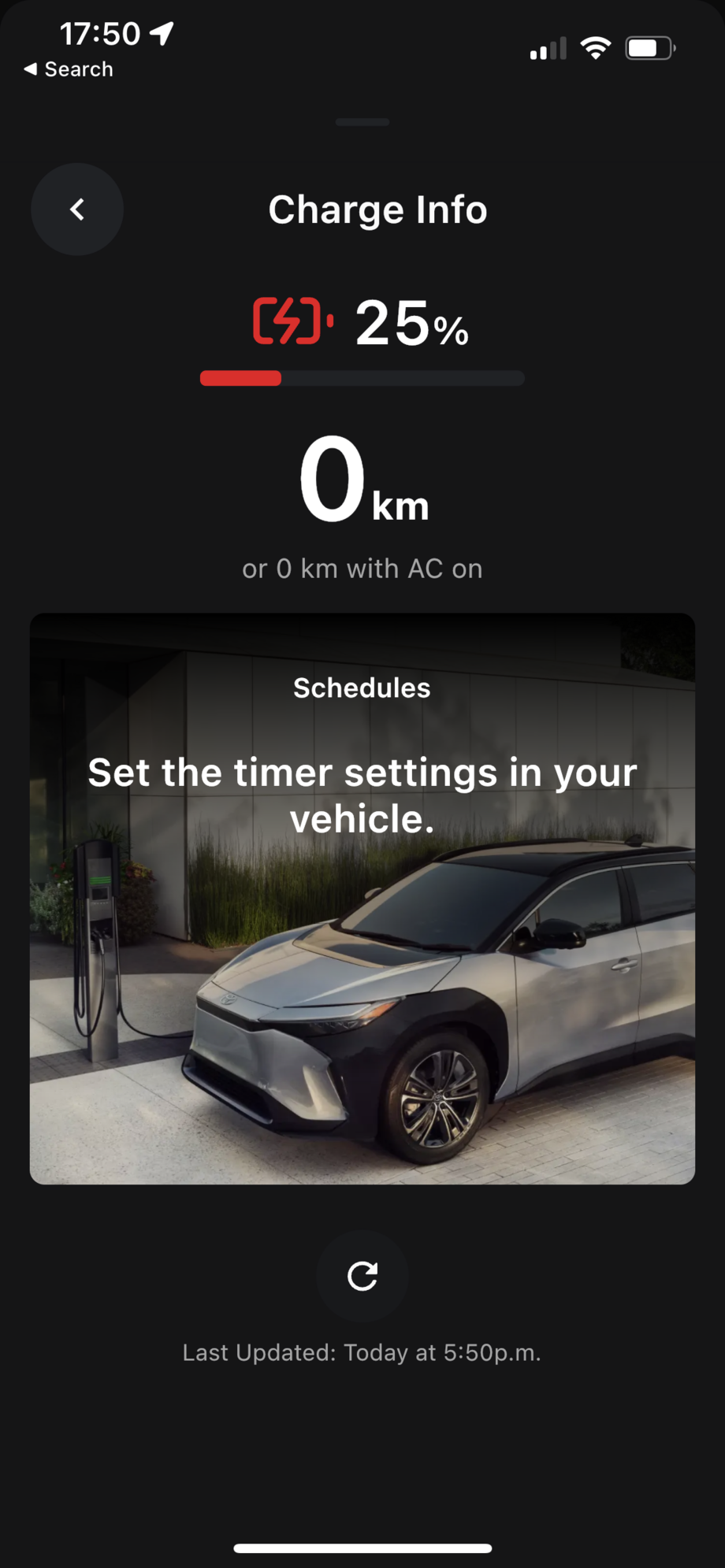

I used all the EV battery range driving around today and it appears that the 450h reserves 25% of its capacity...so it actually never gets to 0.
Interesting... Mine stops at 30%. It says 0 km left with 30%.
