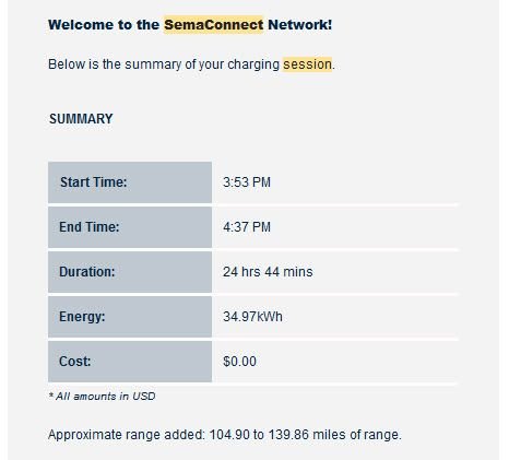

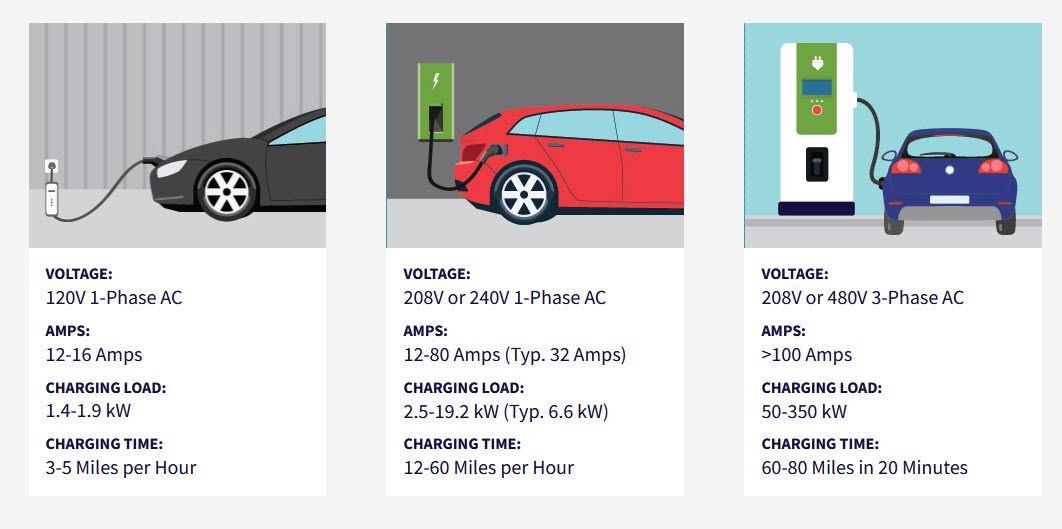

The following pictures are from a SEMA CONNECT - Level 2 240v flexible amp up to 50A
My apartment has free chargers, but my office and houses have electrical prices @ about 3.5 cents + transmission or near 8 cents all in -> 60kwh charge costs $5 in electricity
I drive pretty hard, pedal to the floor everywhere, I get about 160miles per tank/charge no matter what car I drive
At $3.50 a gallon, on a 15 gallon tank, I'm spending $50 a tank
My energy contract is up for renewal, my strike price with my broker is 4.5 cents + transmission, I assume my costs will go up
I also just leave the car plugged in even after it hits 100%, that is why the screen shots show such long times, I'm too lazy to unplug it

I am looking into getting level3 chargers installed where I can, just waiting for pricing on the chargers themselves to drop
https://clippercreek.com/level-3-ev-charging-stations/
https://pluginnc.com/charging-levels/
