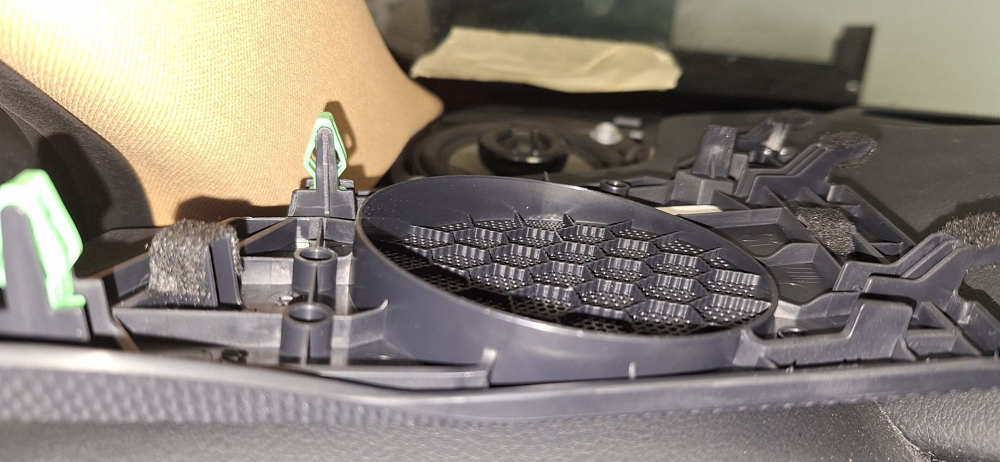

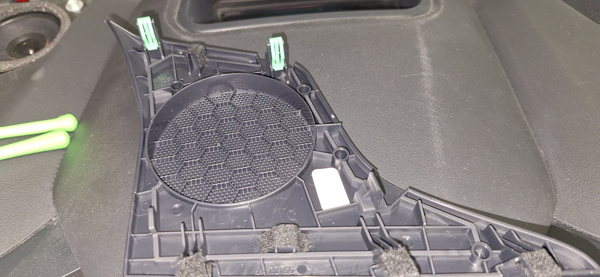

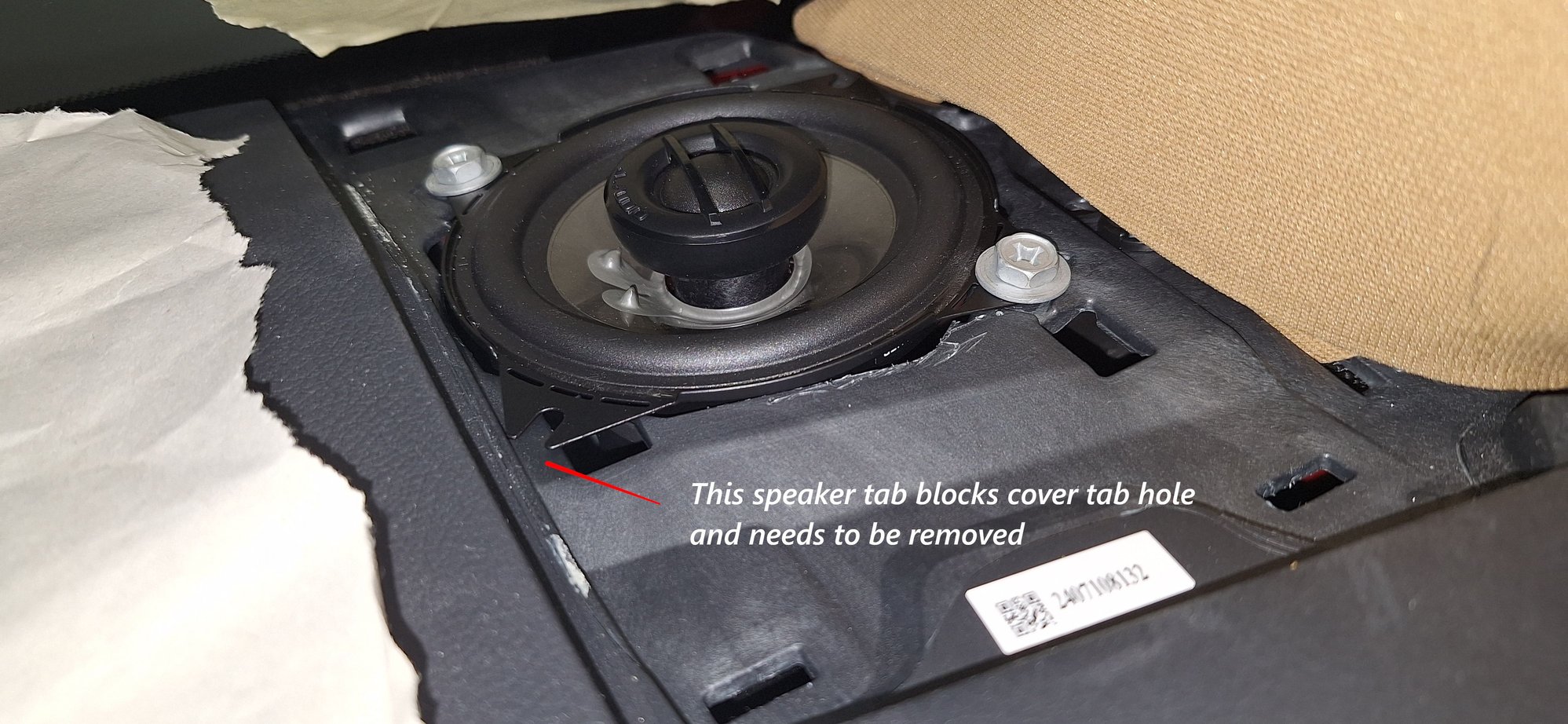

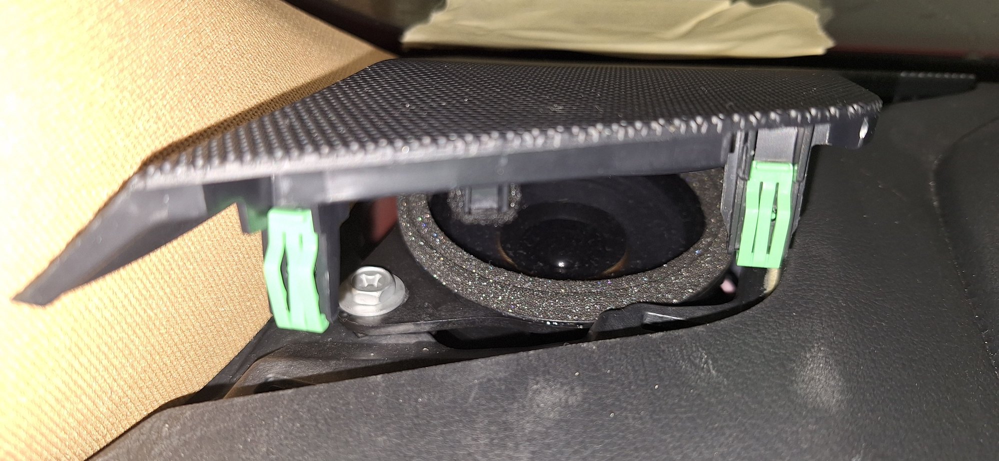

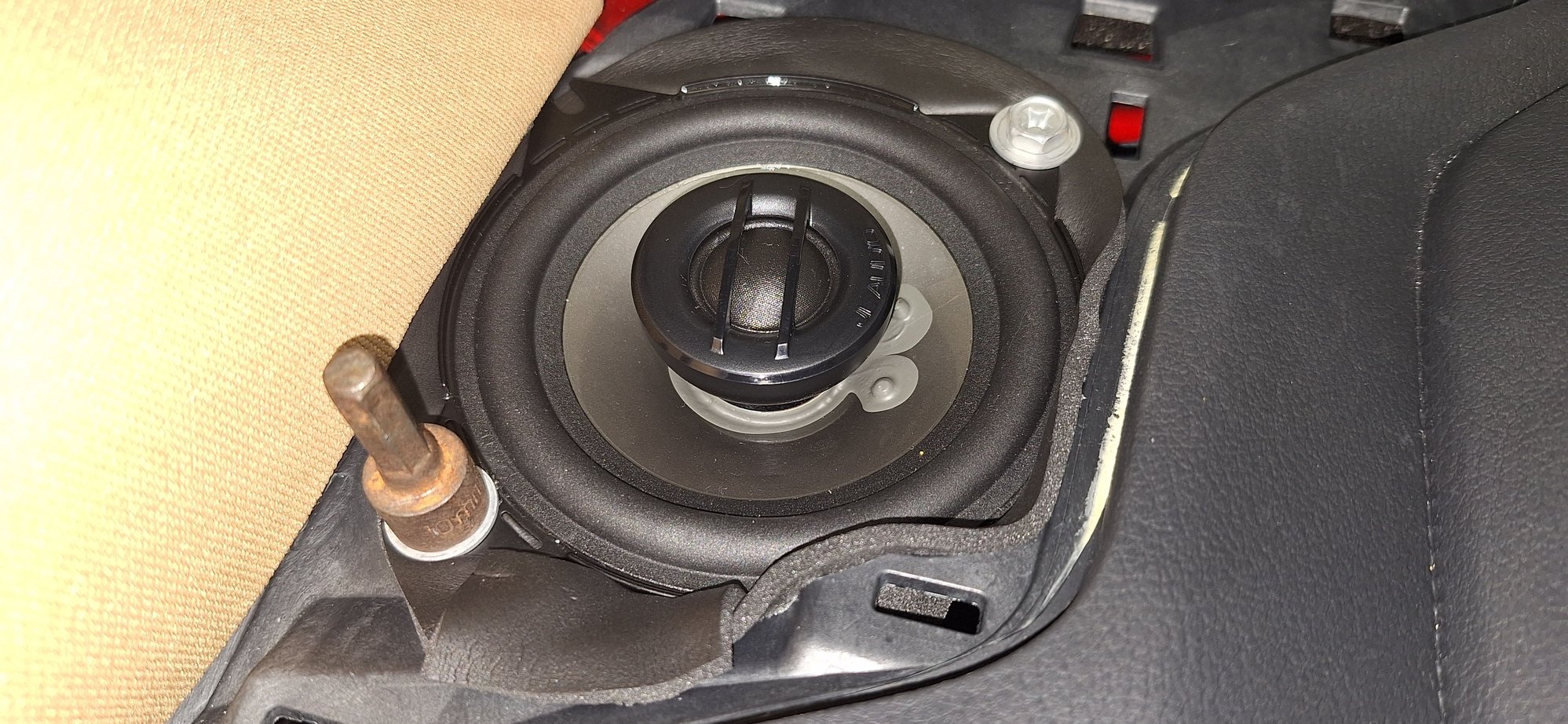

One more set of photos for dashboard speaker upgrade. As it's not about subwoofer, I don't think it's good fit for the subwoofer mega-thread.
I don't use surround and left the factory one in the middle as it doesn't make difference for music then.
In retrospect I would probably need to remove excessive sponge sheet below the speakers, as it sounded a bit muffled at first until I added more treble.
I saw some post about 3" factory grille opening being a problem with 4" speaker. I don't think it's, as:
1. The replacement is coaxial, and the tweeter is much smaller than the opening, so i doesn't matter for treble.
2. By Huygens-Fresnel principle, diffraction dominates anyway when opening is below wavelength, i.e. frequency below some 4-7 kHz. Which is around tweeter-woofer crossover frequency. So in practice it doesn't matter for bass, you would only get some extra diffraction mid-range. But 4" has 78% more cone area than 3", and it matters more IMHO.

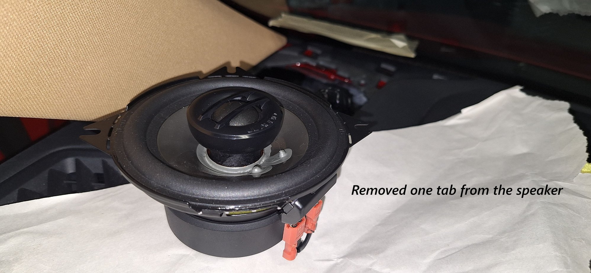

Materials:
JL Audio (TM) C2-400X 2-Way 4" (manual here). Some $144 new from eBay reseller.
No-name neoprene sponge sheet with adhesive, 1/8" thick, $8.
No-name neoprene sponge sheet with adhesive, 1/2" thick, $12. May be unnecessary.
Metra(TM) Speaker Harness for Toyota, 72-8109, $10. Or you can cut factory wire and use crimp tool if you have it, to attach standard connectors and avoid excessively long wires.

No, you can see it through grille at some 7-10 mm below.
