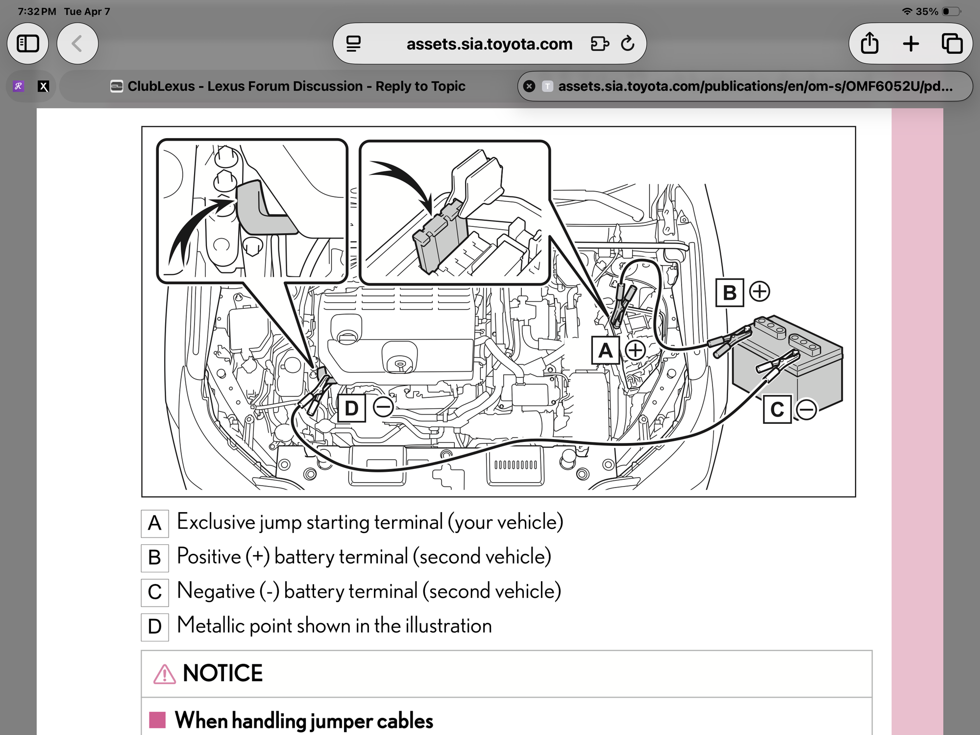

My 26 Nx+ is always parked inside my garage. Can you trickle charge the 12v battery from under the hood (open) in front. I am talking about connecting the positive cable to red terminal inside fuse box and the negative to the left side of the engine as documented (used for jump starting).

You could trickle from the front. In fact, Lexus OEM trickle charger is connected to the front and having a stock in the grille.

Grounding location is very important when changing from the front. I have read the wrong grounding location have caused some damage to the electronics. I have tried a few different brands of battery maintainers in the pass and found NOCO to work the best.

I trickle charge my NX350h from the front when I know the car is going to sit for a week or more using the method You described. I use an old 1.25 amp Battery Tender Plus that I purchased 13 years ago for my Corvette (which I no longer own). The Battery Tender works like a charm!

So you have 3 choices, 12v, 12v agm and lithium. The 3 use diff charging voltage so be careful. Use the first setting 12V when charging lead-acid battery in your NX. Noco is very well protected and safe to use, just make sure you follow grounding instructions.

Default Can someone elucidate on the maximum charging rate up front ?
Over the years I've read different info on this topic on these threads. If you are charging your battery on a 350h (hybrid) I recall that the maximum charging rate in the engine compartment not the back of the car where the 12v battery is.....is a maximum of 2 AMPS..... has anyone seen ANYTHING from Toyota indicating we can safely charge the 12v battery from the front of our Hybrid at a higher rate ? If so, would someone share a link ? Feel free to correct me if I am incorrect....

When you jump a NXh, the peak amperes is much higher than 7, so 7 amp is not an issue. Besides that, the maximum charging current is regulated by the charging circuit, not the charger. The noco chargers charge at full rate for a only a few minutes, then it steps itself down. I have a noco 5 amps and my meter only show 2 to 3 amp max.

Those front terminals are for jumping your car with another car according to Lexus. Sometimes it is dangerous to connect directly to a dead car battery due to hydrogen gas discharge when a battery dies, any small spark could caused a fireball, I believe the Lexus batteries are vented. I have always used battery maintainers, not so much chargers, I have some lithium battery jumpers which works 50% of the time, depending on how dead the battery is I guess.
