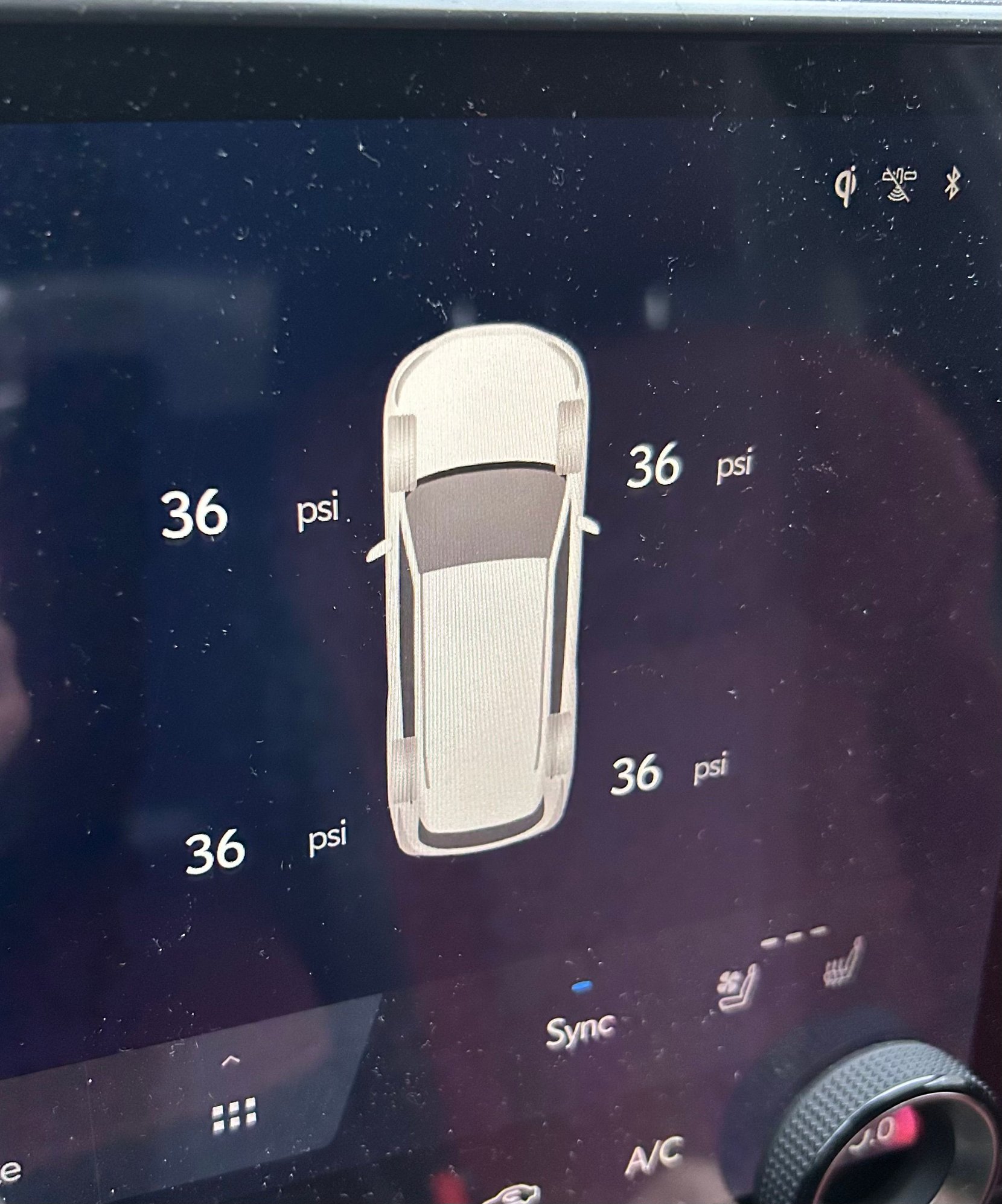

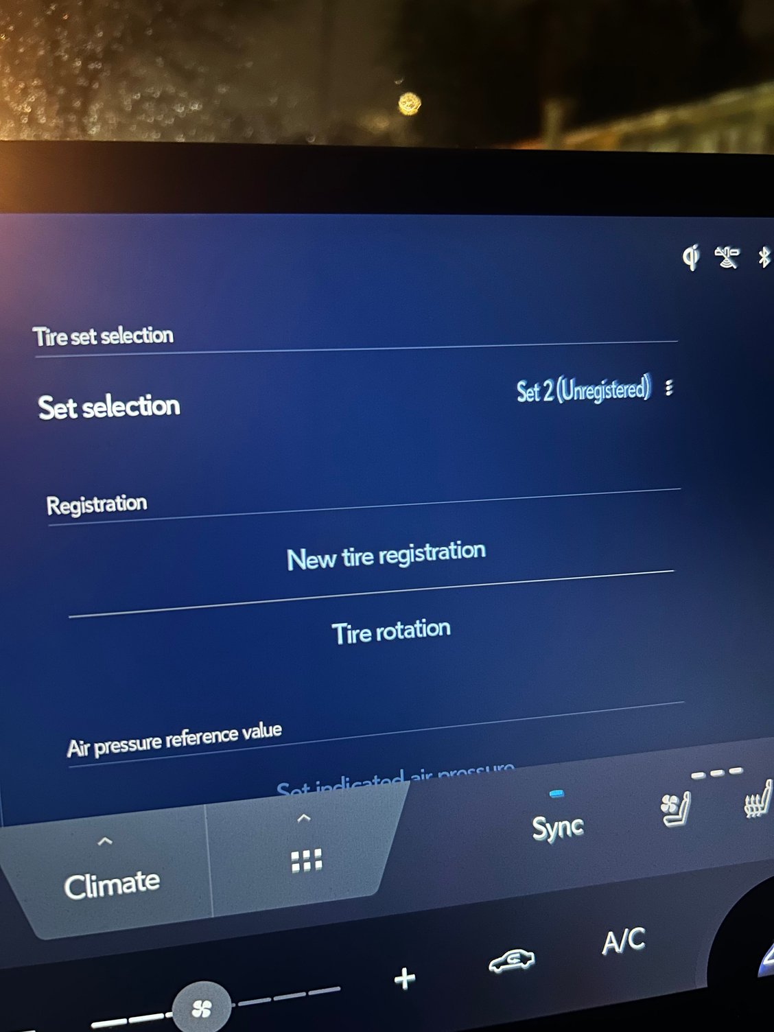

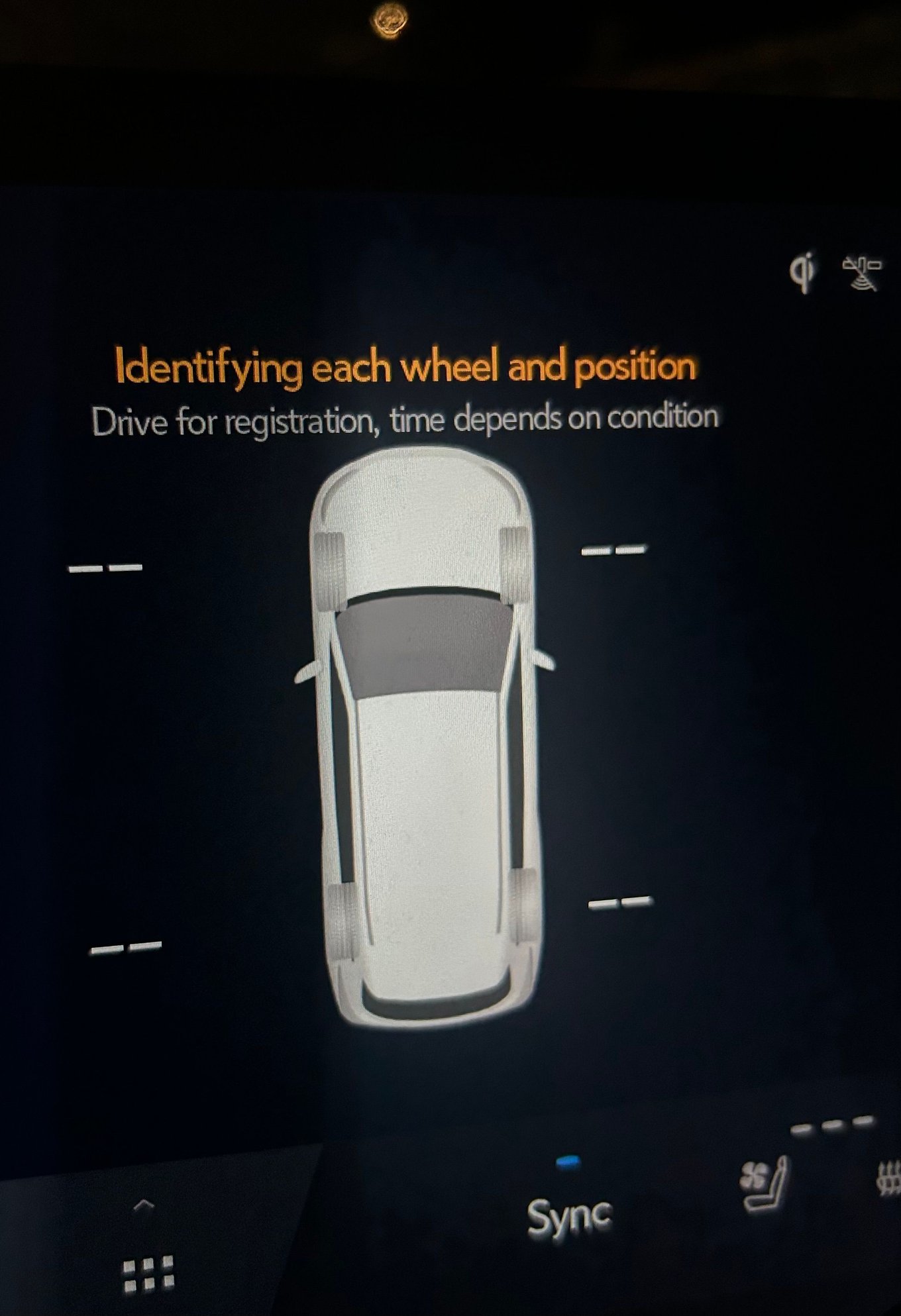

We took delivery of our 2026 NX450H+ last week. Ordered winter tires and rims from PMC Tire which they supply with pre-programmed Max Sensor Gen 5 TPMS sensors. Carefully followed the procedure in the manual for registering new sensors 4 times (2 times drove for 2 hrs) with no success. I was not encouraged when I saw this link. My question is, has anyone had success with this brand of TPMS? I have contacted PMC Tire and hope to hear back next week.

Old Nov 30, 2025 | 11:18 AM
bbosh's Avatar
bbosh
Joined: Sep 2025
Posts: 16
From: Ontario
This morning, we drove the car (same usual route) and within 10 minutes the air pressures popped up on the screen, new wheels registered. No success in the previous 5 trips (probably 7hrs total). I guess I just needed to be more patient. Just curious, in the manual it lists reasons that registration may not happen easily - one is driving on unpaved roads. Our roads are not unpaved but we have had a lot of snow the last few days with snow packed roads - perhaps that is why it took longer? Anyway, happy its working now.
