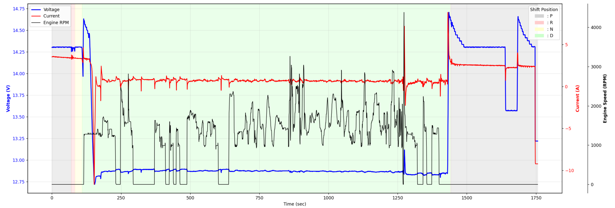

I used the OBD data to log the 12V battery voltage and current during my commute.
The "high voltage" charging is only occurring at the beginning and at the end.
I need to track other parameters to understand what is happening.
I have traffic / traffic lights in the middle of my commute so there were certainly times when I stopped, but somehow the battery wasn't brought to more than 13V at these stops.
At the beginning and end we're you in Park and not in drive?

I logged the gear selector position and the engine rpm.
At the end the dip is voltage is me turning the low beams ON and OFF to see the effect.

As you can see voltage for most of the trip is 12.8 there abouts. Same as mine a 2025 450h+. Your battery will never be fully charged The people that built this are smarter than us but this really makes no sense
The battery is supposed to be charged, so it just "disconnects" it: almost no current flowing.
This makes more sense than constantly forcing the battery at 14.5V.
Just from my graphs I don't think I can tell that anything is wrong.
I suspect the spikes over 14.3 V followed by a decreasing voltage is the car measuring the battery state of charge.
At the beginning it measures and decides that it needs to charge even though I am already driving.
Same at the end: you can see the car measuring and charging because I intentionally kept it ON for a long time.
So basically the car starts: measures SOC --> charges
When driving: keep battery floating
When stopping: measures SOC --> charges, if given time --> so waiting a little can help maintain your battery.

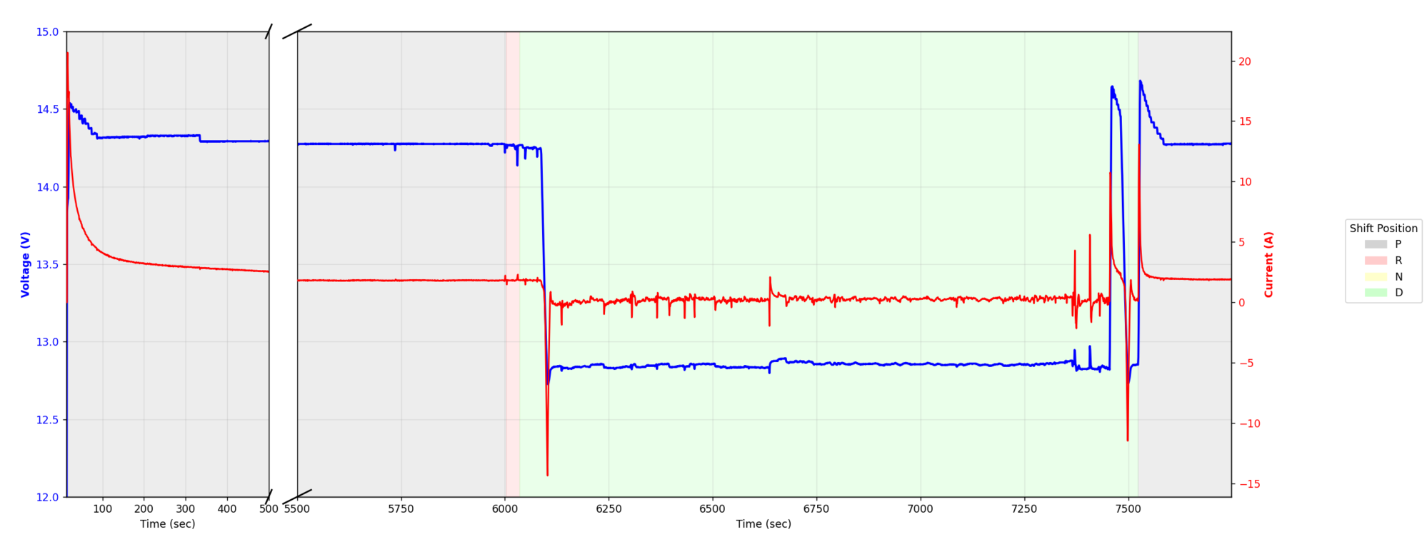

I turned on my car and left it in park for 1 hour and 40 minutes before driving.
I stays in "charge mode" and the current stabilized to 1.7A.
Then after driving upon reaching my parking space, it does it's battery SOC check.
I wonder how it decides that it's time to do it. Does it use the camera to detect that I am parked, or the proximity sensors feeling the obstacles around my spot?
But it only measures and then goes back to the "driving mode".
And then when I park, it again does the SOC measurement + charge mode.
