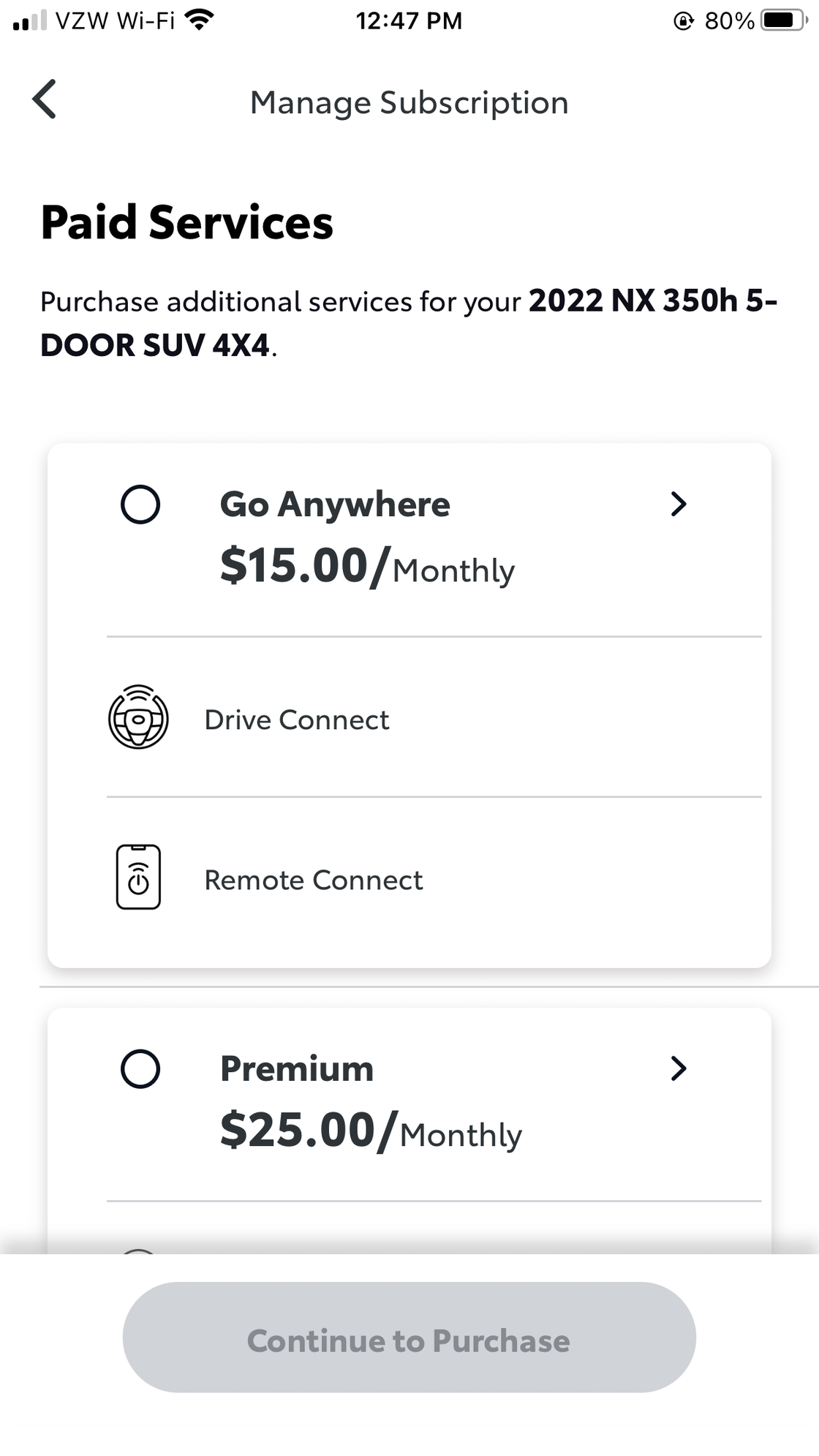

Unlike some forum users I actually like "Go Anywhere" , some call it "Drive Connect", but Lexus calls what used to be "Drive Connect", "Go Anywhere". It costs $15 per month plus tax. Without Go Anywhere you still get speed limit displayed on your dash and HUD. With Go Anywhere, in additional to speed limit, you get stops signs, school zones, etc. displayed on both the dash and HUD is you have custom option Road Sign Assist set to "Yes" and HUD, display mode set to maximum.
YMMV,
MidCow3

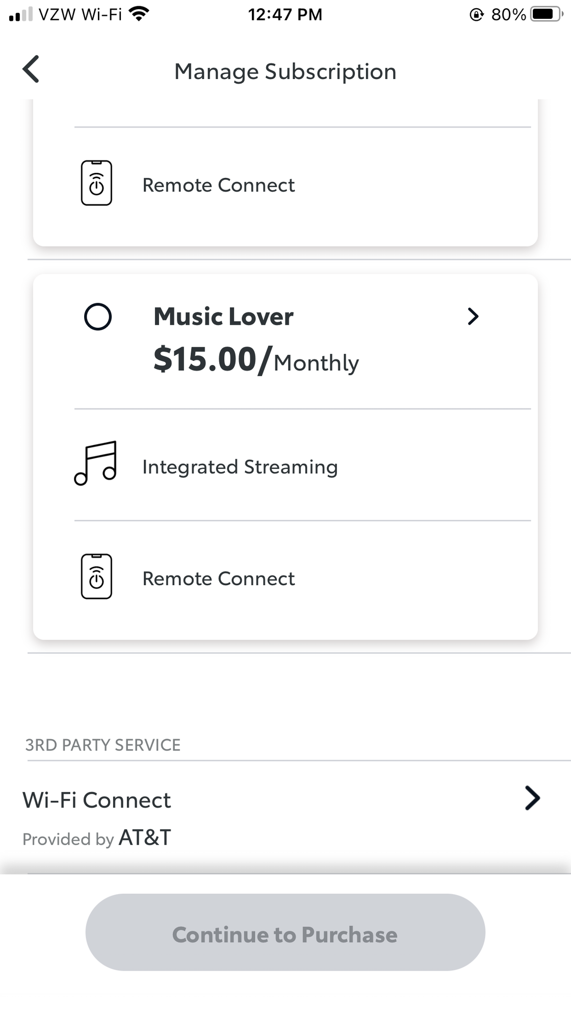

Here is the difference: ( and yes Go Anywhere is cheaper ) Here are the three(3) services offered
YMMV,
MidCow3
