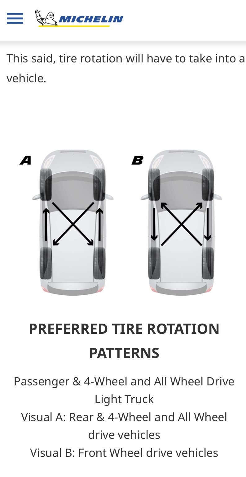

If you have non-directional tires you should do some type of cross pattern to optimize even wear. If you have directional tires, rotate front to back. If front to back rotation is not giving you even wear dismount, mount, re-balance to accomplish a cross pattern rotation. If you have AWD, x pattern seems best. If you have different sized front and rear tires, rotate left to right.
Tire Rotation Examples

Agreed. I’ve always done the A pattern on my AWD cars.

Informative diagram
