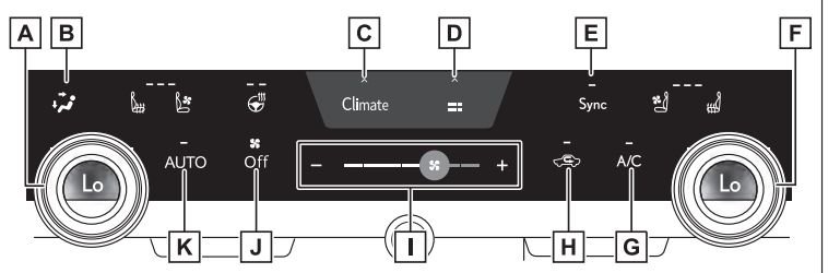

Are you referring to the 3 dashes above the seat controls? If so, they indicate the status of the seat heat/ventilation settings. The number of blue dashes indicates the fan speed of the ventilated seats. The number of red dashes indicates the seat heater power level.

No, it's not the dashes for the seat controls. It's a single dash above the A/C or recerc air symbol. The selections when you press the legend are: white, gray with a gray dash, or gray with the blue dash. I still don't know what that blue dash means.

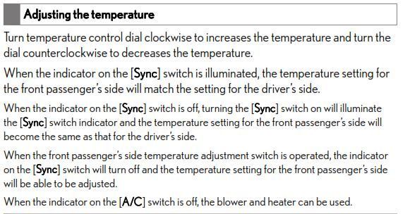

The only button I can see in a place where you are describing is a Sync button.

Ah yes, I understand which dashes are being referred to now, and yes, this is the answer. For the recirc control, blue means on, grey means off (fresh air), and I believe "nothing" indicates the mode is not selectable with the current air flow mode. For the AC control, its lit its on, if its not lit its off. There is a lot of automation and customizable features selectable which makes the climate controls not overly intuitive for what actually is happening. I usually leave my system in full auto all the time (or simply off if I'm running with the windows open) and it serves me well 99.9% of the time. I think I've had to actually use the manual defrost mode only 2 or 3 times in 2 years (benefits of parking in a garage). The last time I had to use it I remember having to pull over because I could not remember where the control for it was.

Thanks for the update and I think you're probably right. It has something to do with the "AUTO" or "S" mode settings. I haven't played with it in a while because I'm still driving my older GS. The picture in the thread from oreon333 is different than what I have. My display has the small dash above the recirc and A/C and AUTO symbols. Same as what you see above the Sync symbol.
