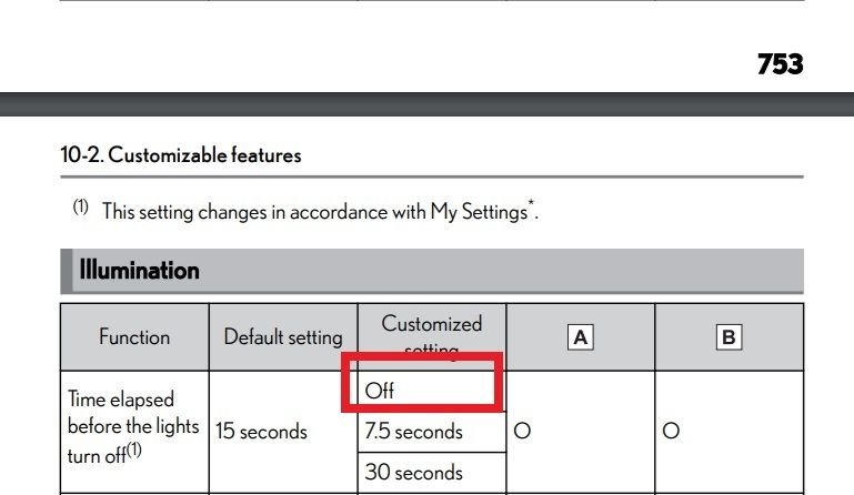

I make a habit of rotating the headlight switch off all the way then back to auto setting every time I get out of car so I force the headlights to shut off right away and not time out. I lock up the car with the door handle button and walk away and place the fob into a faraday pouch as well. So as quick as I can I 'shut down' the car right away and not have it 'looking' for my keyfob. When I wash car for example I unlock it and then put keyfob into faraday pouch as well, so I'm able to open and close doors if needed but again, don't have car awakening by fob thinking I'm gonna step in and drive it.

Yes, for 2022 Lexus NX other years similar.
if you every need to get access to an online Lexus manual, save this link : https://www.lexus.com/My-Lexus/resources/manual

How did you know I already set that setting? You must be spying on my car settings. But unfortunately, if the headlights are on and the car auto powers off after 1 hour, even with that setting - it stays on... maybe you should try it and let me know if you car does that... oh but you have an 350h which might not be that safe to keep in the driveway and let it run for 1 hour.
