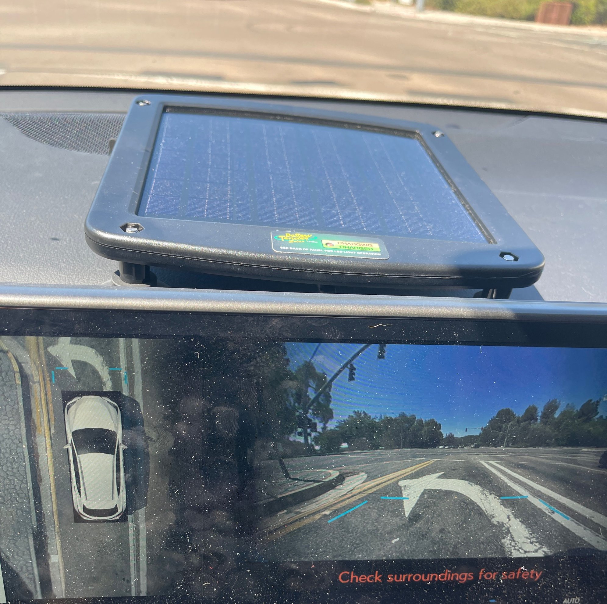

This is what I use to keep my battery fresh while away on a trip and left at the airport.
And how well does it work for you, do you know? Being inside the car one would assume that the windshield blocks a lot, and you panel would be better if it was outside but hey what do I know
Your probably right it would work better if not behind the windshield but I don't want to tempt anyone (keep the honest man honest) Seems to work well inside the car. I left it pugged in for about 3 weeks and no ill effects. People mostly use them in there RVs that sit for months with no use. The last thing I wanted was to come home from vacation to a dead battery in the long term airport parking lot. Solar powered, so it's not plugged in like the Battery Tender I use at home.
Nice solution
