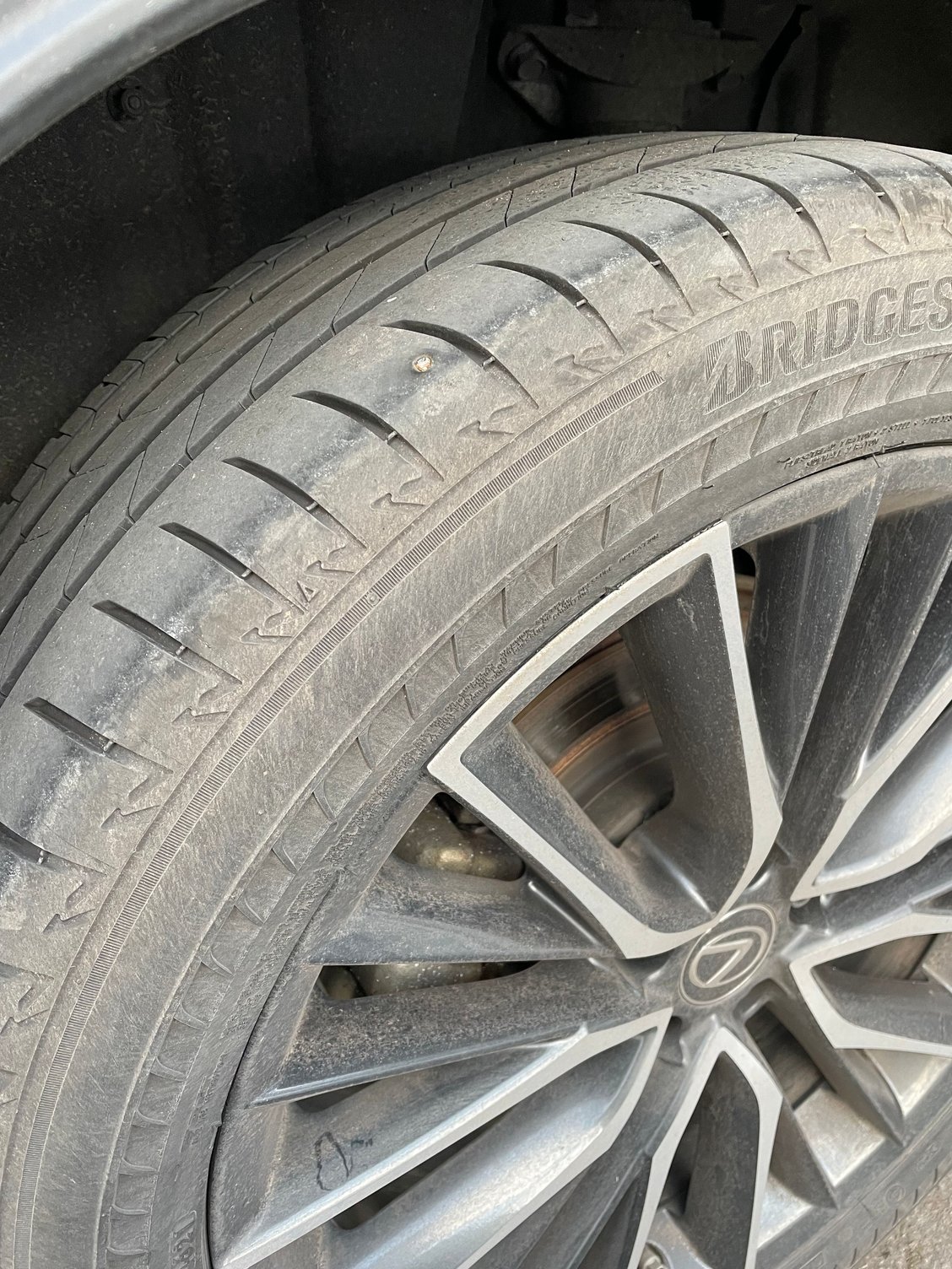

Got a screw in a rear tire along with a slow leak. Local tire shops did not want to patch the tire (policy?) I got a gas station plug - not the best solution but seems odd that no one wants to patch. It's mixed but most online advice says you can patch the tire once if you have not driven the tire with low pressure.
Any feedback or opinions ?
I don't want a new expensive run flat and I would prefer not to have mixed tire types on the vehicle.

I had to replace mine because the nail was too near to the edge. It became clear after doing research that Bridgestone run flats fitted can be repaired if the puncture is away from the wall and subject to normal tyre repair rules.
Nail too close to tyre wall….

Yep those are my tires. It was a screw in the middle of the tread. The car was not really even losing air - after it hit 28 psi. I wanted a patch but settled for a plug.
Seems fine for the moment.

I had a nail in one of mine. It was losing air slowly, not running flat. I took it to Discount Tire. They said they could patch it, since the sidewalls weren't damaged. I assume they would be damaged if I drove with the tire completely flat.

Got mine repaired (patched) at the Lexus dealer on the 2nd weeks, got the same type of screws as the posted picture up there, been puting on 4k on it and on my 2nd year now without any problem

Most run flat tires can be repaired if the pressure never dropped below certain value (typically 22 psi). On the other hand, if the pressure dropped below this value and the tire was driven upon for any extended period of time (more than a few hundred feet), it has to be replaced.
