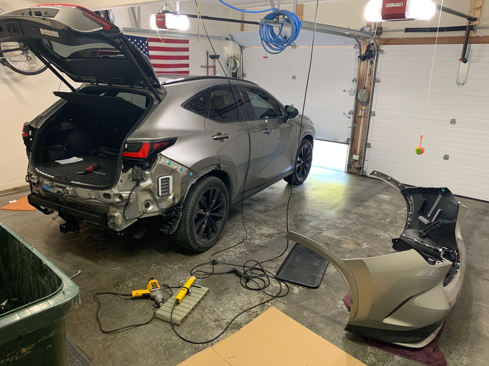

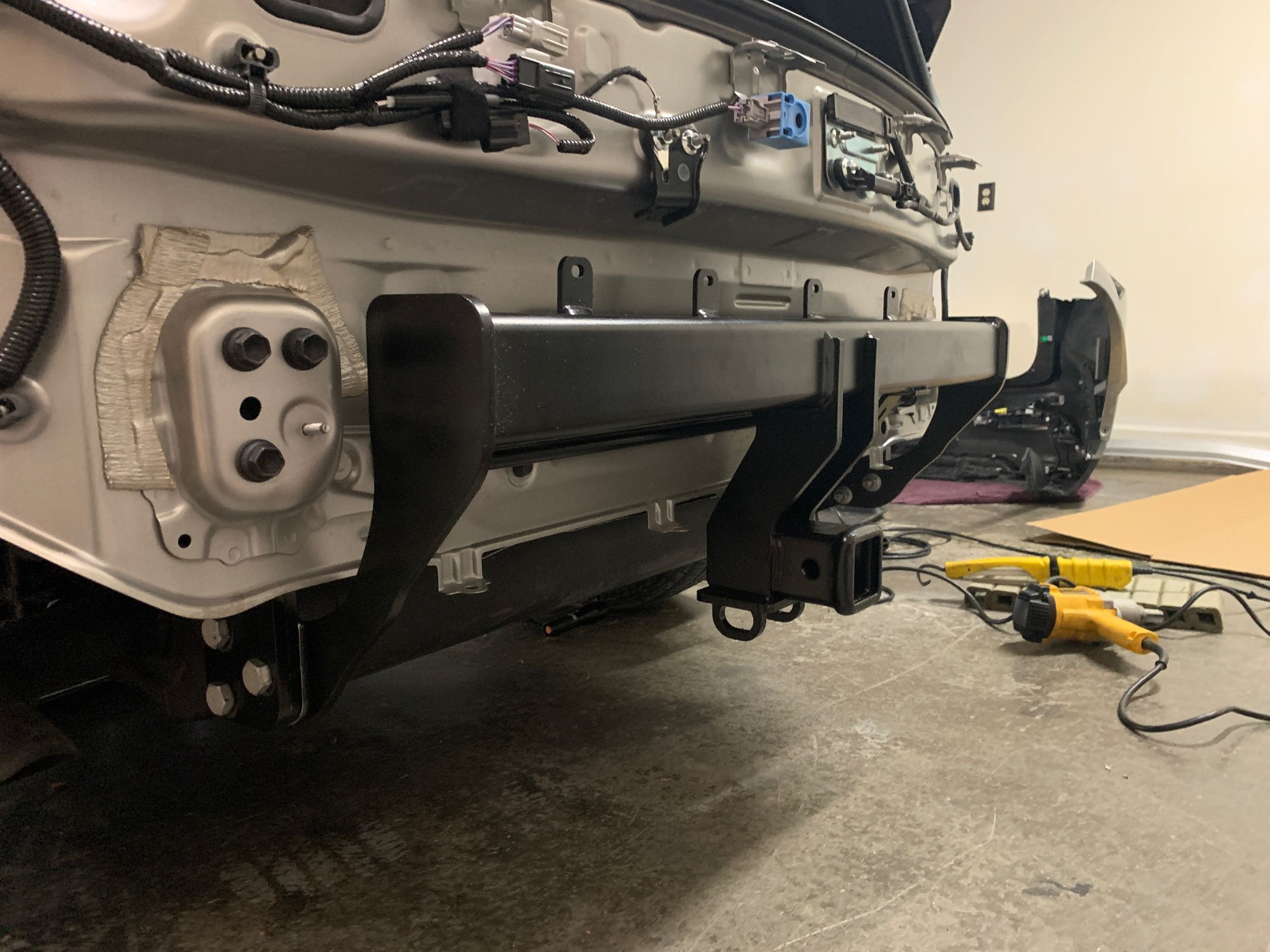

I just finished installing a Lexus OEM trailer hitch and wiring on my 2022 F-sport. Unbelievable amount of work. If you have questions ask me.

Wow! Great job joeh80, looks like a ton of work. The results are great though (vs. the aftermarket hitches).
Was the wiring similar to the instructions posted by Gerge? They also seen very complicated (for example requiring exterior fender trim removal).

You have to run a wire from the battery all the way back to the hitch. Lexus says you would put too much of a load on the LED system if you try to splice in at the rear end. You have to remove the windshield wipers and the wiper motor plus the metal and plastic panels that they rest on. You have cover the wire with lithium grease just to pull it through the firewall and then remove the three panels under the steering wheel. Then you have run it next to the drivers seat and then next to the rear seat pulling plastic panels all the way. You have to remove everything in the rear compartment on the floor and both side panels. You then have to remove the complete rear bumper that you see sitting on the floor. Cars now days are just plastic panels that snap together and require a good set of non scratching nylon tools to push and pull the panels and the connectors. I didn't see George's plan but Lexus will supply you with the instructions if you buy the parts. The wiring instructions were 16 pages long and mostly just pictures with vague directions suited to a trained technician. I got the car back together and ithe wires are working correctly. Oh and you have to disconnect the negative battery cable the whole time you are working so you don't accidentally set off an airbag.

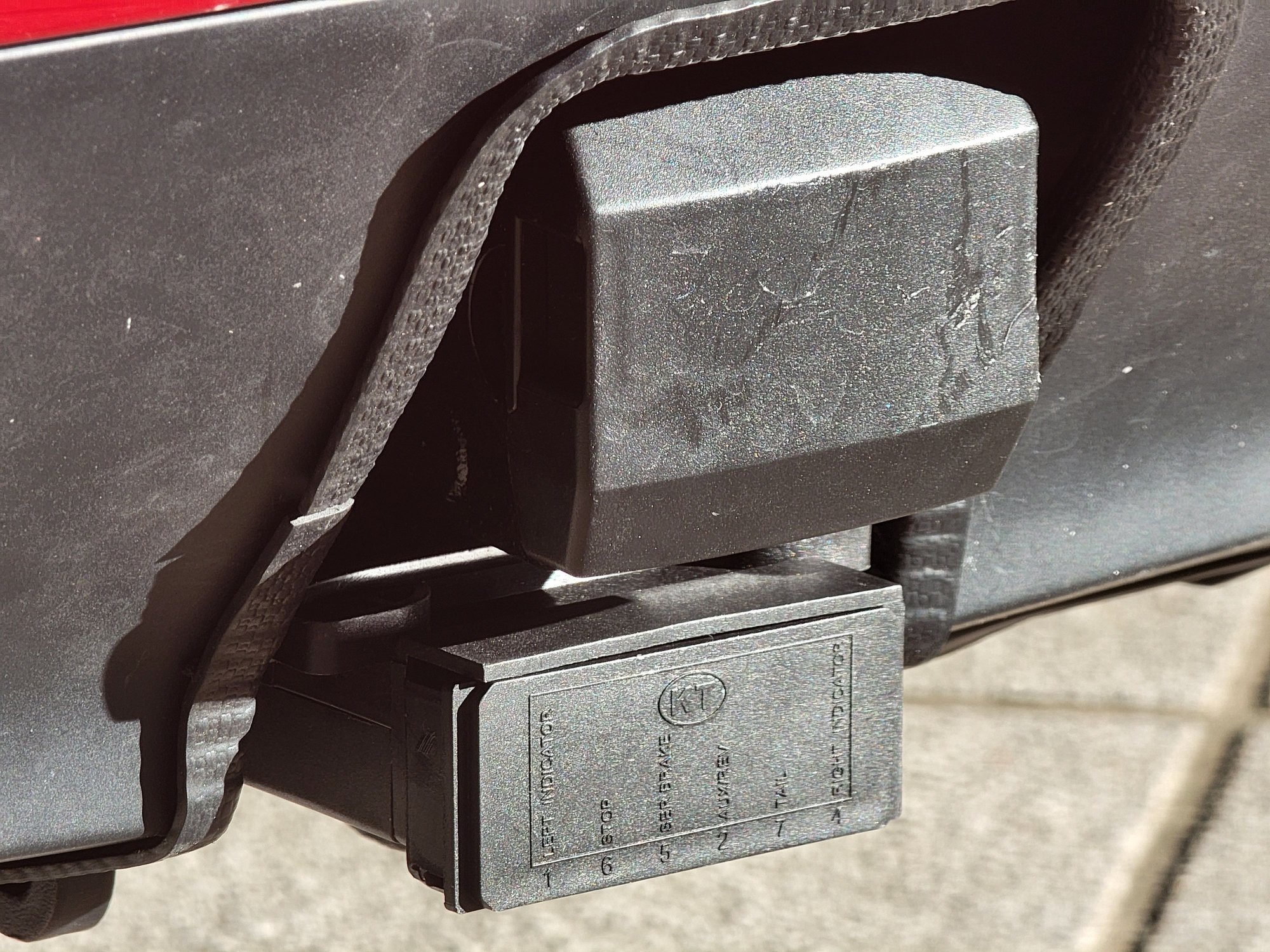

From the very next hitch thread. DO NOT HAVE THEM CUT THE SIDE NOTCHES, ONLY THE CENTER. This is the plastic bumper cover. Plastic is plastic, Fsport, NX, or Rav4 is all the same install. There is a lot of good info in some of the other hitch threads you should see to make a more informed decision, especially as it relates to departure angle. Rav4world also has pictures of all the brands of hitches and where they come out of the bumper.

This is neat cut & trim in GS.
Here's a dirty example.
