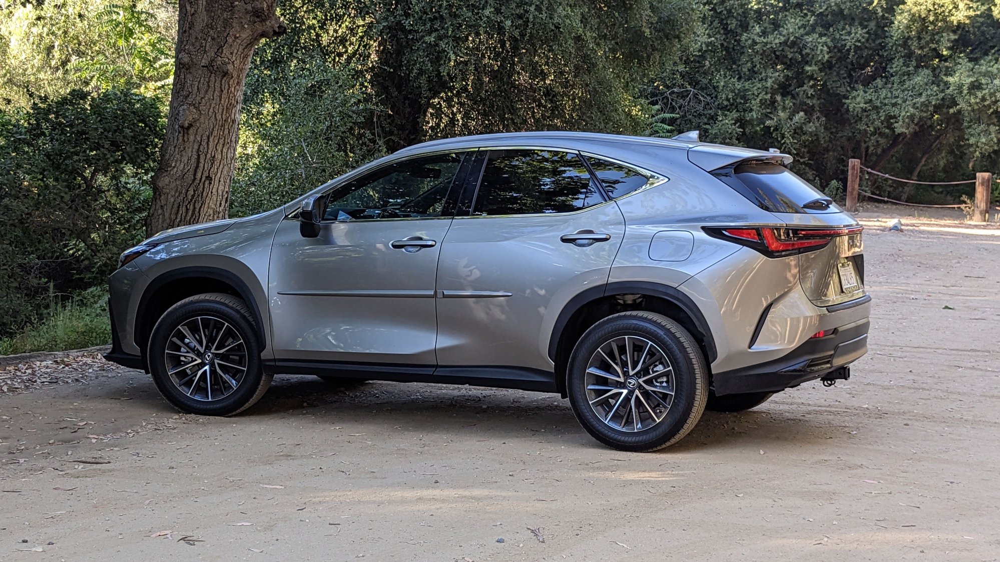

I used the Gen 1 body side moldings. Heat bent the shape to match the door first. Use the actual color number (not the name) to make sure it matches. Experimented with location and slope to arrive at where I put them.

Pretty easy if your patient. Lexus has directions although I experimented on the location I liked best with blue painters tape holding them on. Once I has happy with location, but some blue tape tabs along with upper right and left edges. Peel the mounting tape and align molding to your tape marks. For the rear doors, I sighted from the back and front to make sure it was in perfect alignment to the front before finalizing my blue tape tabs. If you use gen 1 moldings, you will need to carefully heat bend the molding with a hair dryer on the forward foot or so to arc the molding to match the door shape. It may not be necessary and they may work without doing that, but I did not want the moldings to pull off. I like the gen 1 molding better, but that is a matter of taste and if your color is available. Good luck
