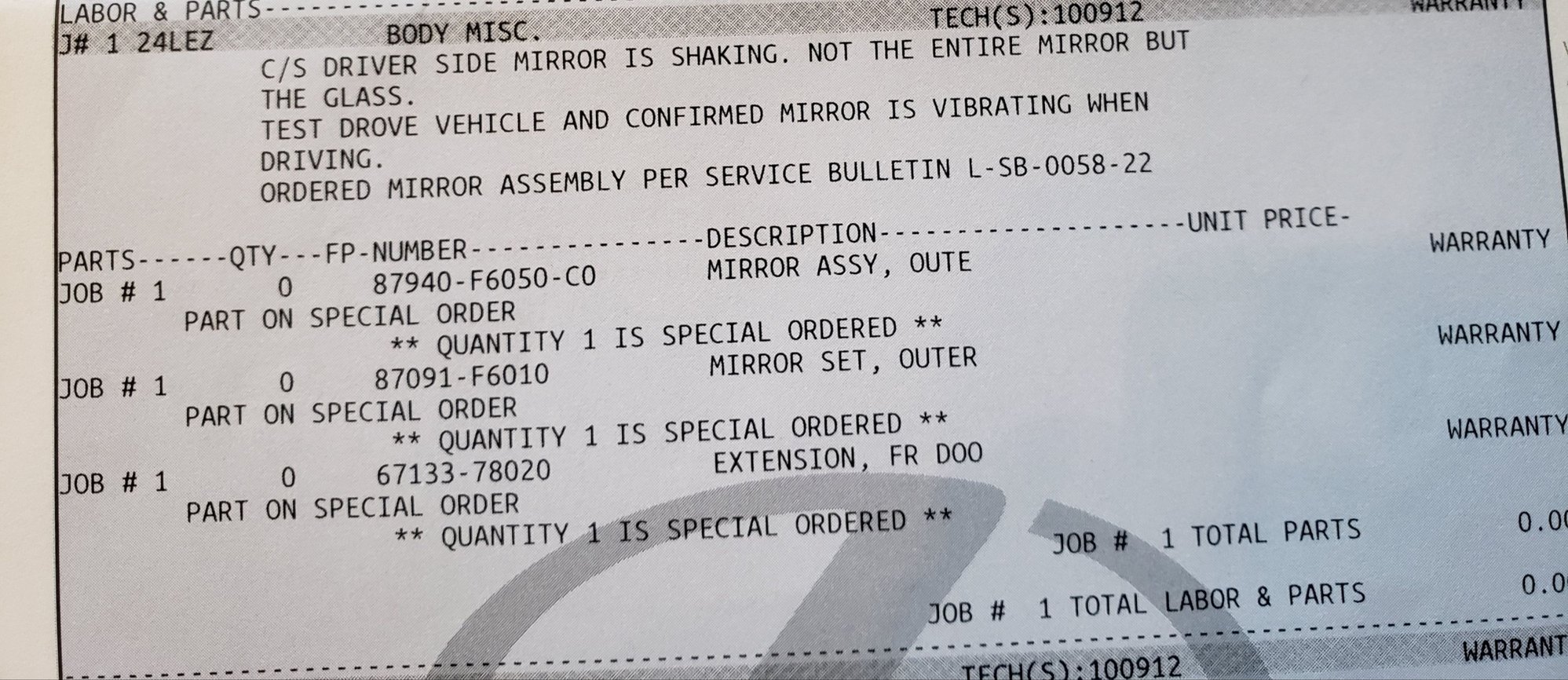

Me again, I took my vehicle in to the dealership b/c my mirror was shaking badly and I told them about the TSB and this is what the service department did. Please advise is this is correct. See photo and
Thank you for your help.

That looks correct. If you scroll up a bit in this thread, DerekGX460 posted a similar service sheet with the part numbers as well.

Apr 19, 2023 | 03:44 PM
Quote: That looks correct. If you scroll up a bit in this thread, DerekGX460 posted a similar service sheet with the part numbers as well.
One of the PN's looks different.
F6021 vs F6050

Apr 19, 2023 | 04:14 PM
Quote: Me again, I took my vehicle in to the dealership b/c my mirror was shaking badly and I told them about the TSB and this is what the service department did. Please advise is this is correct. See photo and
there are 4 different part # for the mirror assembly, dealer will order the correct part according to your VIN.
