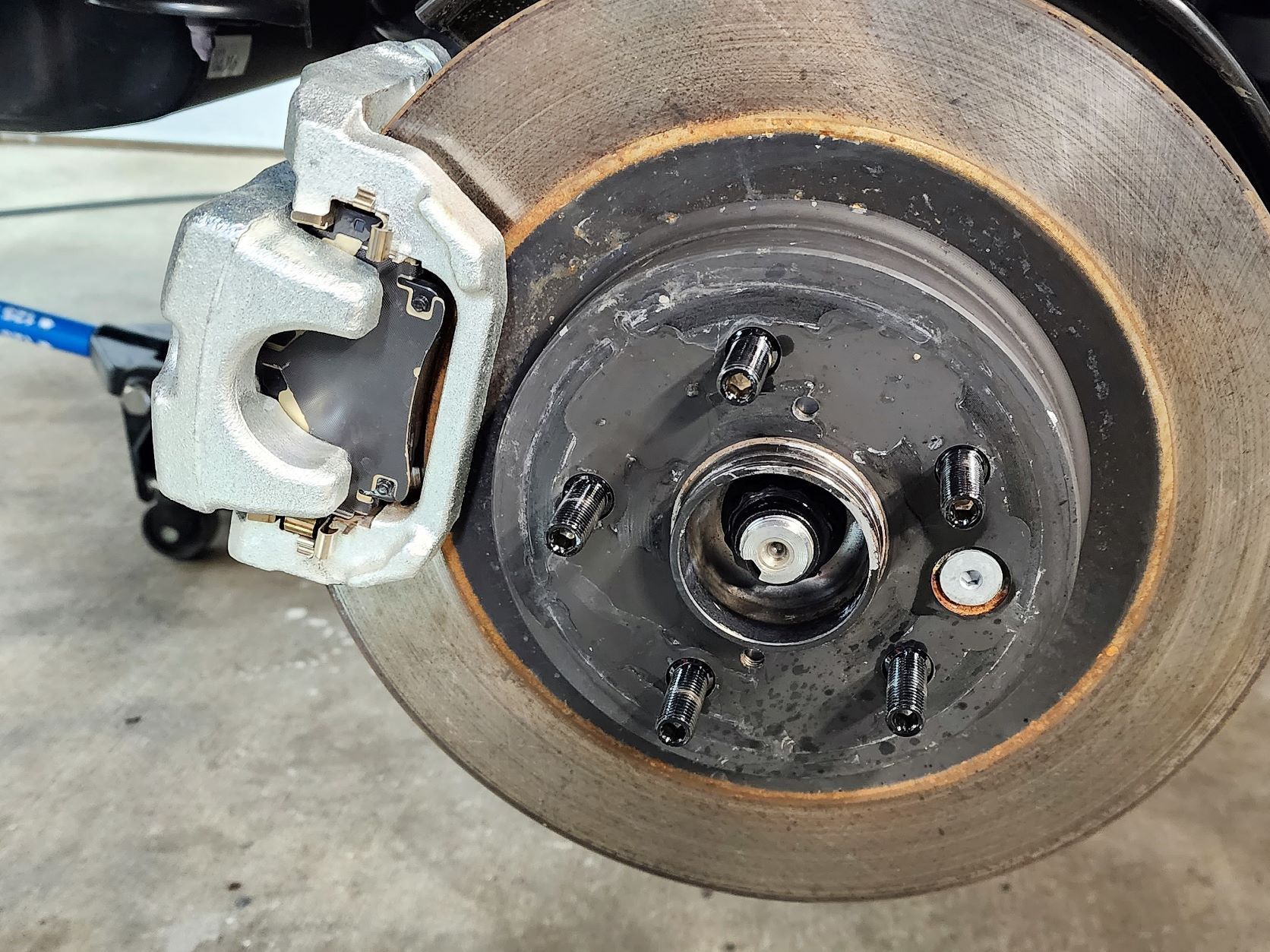

1) The wheel bolt/nut system - A total shock to me when I swapping my winter tires. I thought I can still fit my Gen 1 into the Gen 2.

Someone needs to correct me if I am wrong.
Gen 1 uses a nut style to secure the rim.
Gen 2 uses a bolt (mostly used by European Cars) to secure the rim.
The problem I was told when I swapping in my winters, the mechanic said because if this, my existing rims would not fit. It could be the garage is lying to me, but I don't see the reason why.

The thing with the old style nut fasteners is, it doesn't matter what the holes on your rim are like; the nut grabs onto the studs and holds your wheel in place.
With the bolt style, the rims have a recess and each hole which corresponds to the conical tapered base of each wheel bolt (technically, a part of the shank). So the bolt actually goes a bit recessed into the rim allowing for better grip and less vibration of the entire wheel assembly. The very design if this wheel assembly relies on that part of the shank being recessed within the room as opposed to sitting flush like it would on a wheel assembly that uses lug nuts
If your current non-2NX rims do not have that recess around the holes for the bolts, you won't be able to get the bolts to seat properly, causing vibrations, improperly balanced load and the wheels and a bunch of other hazards which you would rather not experience.
So, ultimately, check your rims. If they have the required recessed depth around the bolt holes, have the proper centre bore and the hole spacing matches, you should be able to use them on your new, shiny 2NX

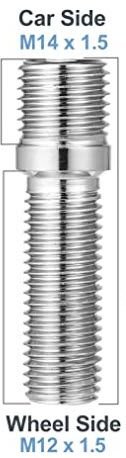

Definitely the new wheel lug bolts for me however you or a qualified mechanic can put your own studs on your wheels like ALL Lexus's had the previous 31 years. The ball radius lug bolts are a cost cutting and in the end a money making scheme for them. They also limit what type/style of wheel you have to use. Not many wheels take radius lug bolts including ALL previous Lexus wheels and 99% of aftermarket wheels.
You can still use your factory wheels ,just have to get ball seat lug nuts.
You or the tire shop monkeys strip a lug bolt hole and it's close to $1000 to replace the whole wheel hub assembly since the threads are in it.
Where if they broke or stripped a stud, like we previously had, and it's less then $20 as each one is easily replaceable.
I previously had a BMW M3 and it was the same ball radius lug bolts. I replaced with studs as a lot of BMW owners do. Read over on the BMW forum of some of the nightmares of lug bolts cross threaded/stripped by tire shops and impacts..
