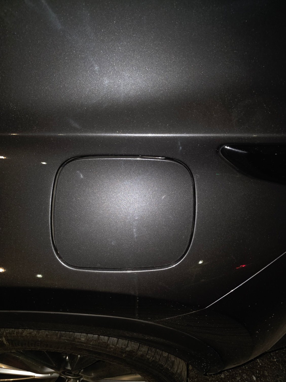

Hello, We have a 2022 NXh 350. We've had this car about one year. Let me state that the fuel door has always looked like it was misaligned. After about six months the fuel door started occasionally not opening on the initial push of the button. In less than a month the fuel door would not open at all. After taking the car in for service and finding the replacement parts were back ordered 6 weeks, our dealer told us to have someone stand outside the car and pry the fuel door open while someone sitting inside the car pressed the button..... This is a luxury SUV? Finally after getting the fuel door fixed, it works but still looks misaligned. Has anyone else had these problems?
I had the same bad Experience in an heavy Rainy day.
I did request the Application of the remedy indicated into LSB relating to such issue, but the local Dealer refused as fuel door was still opening even if being just ajar!
At the end They performed the fix that was the relubrication of the fuel door neck!!
Now it works correctly since months.
My NX is a MY2022 J production 450h+ model.
Great car after an uncountable number of Safety recalls and SW updates, but DC-DC converter fix that for Italian Market is still Waiting for operative instructions to apply remedy!!

dc88 - Did they replace your outer door that’s painted colour of your car too? Did it align up better than original? Mine has terrible alignment like the image shown earlier and just last night it stopped opening so I had to use access port in back hatch to fill up with fuel. I’m hoping the replacement fits much better.

Same for me,was thinking someone tried to open it and damaged.it is misaligned,presses to right side against latch and that causes it not to open.not any grease helps.very hard to reach mechanism,u need to disassemble trunk interior parts.i think it just needs to move a bit to the left.
so problem is not a latch,misaligment causes that

Originally Posted by mjmcggolf
This is the door AFTER the dealer repaired
idk it still looks misaligned how it works properly?did they change whole unit or just a latch?

I will also point out that I've only had the plastic hinge assembly mechanism replaced. They never want to replace the painted steel door. Now I ask you a very simple alignment question here, which one of a two piece assembly is causing the misalignment? Well it would start out as fifty fifty, could be either one. Try one and if that didn't work replace the other. Hmm, I haven't heard of anyone having their painted steel door assembly replaced. And from what I've seen online the painted door is bought already painted just as other trim pieces are. The fact that they all look like they're off centre towards the right side is a simple fix with a change to the stamping die and assembly of the steel door as it's two pieces at least. The outer surface and the inner structure which is a stiffener panel to give it rigidity.

Default That's a two different cars door alignment,second one is mine and its jamming
