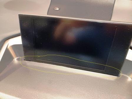

i had similar issue with plastic trim right in front of display. Apparently there was a TSB for this issue and it was fixed under warranty. Dealer applied some sort of sticky tape between this trim piece and the lower part of screen (not sure if this is exact description, see yellow-circuled area).
