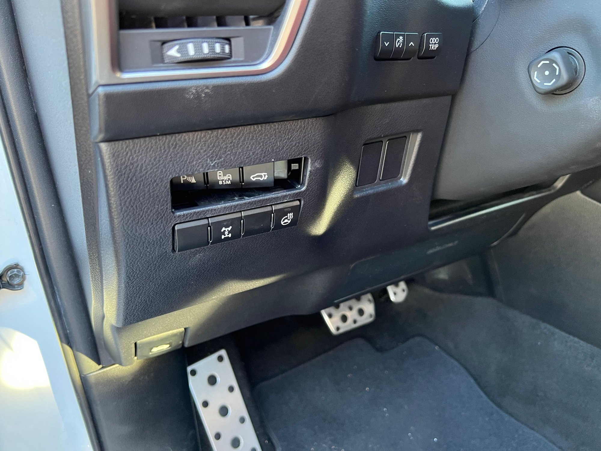

Anyone have this ever happen? Saw it this way last night. Can’t figure out how to get this row back to snap in place. 2016 NX200t.

Refer to attached photos.
Use a nylon trim tool to pry the instrument panel left side cover open. Slide the tool along the edge to release all of the retainer clips.
Pull the panel toward the rear of the vehicle to release tabs located behind the rubber weatherstrip along the firewall. Set the panel aside.
In photo 4, you can see the 2 switch/indicator clusters through the opening (marked with red arrows). Reach in to see if you can snap the dislodged cluster back into position.
To re-mount the end panel, first slide the tabs behind the weatherstrip, align the upper retainer clip with its slot, and then swing the panel to the right until all retainers snap back into place.

HUGE THANK YOU!!! That worked perfectly!!!
