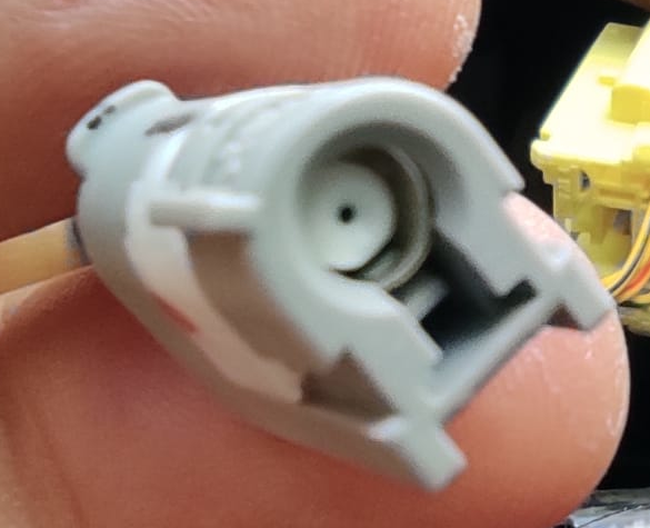

I found an easier alternative which is using the connector under the top board (I don't know the word in English).
Does any of you know what connector standard is this one? It is for the GPS.

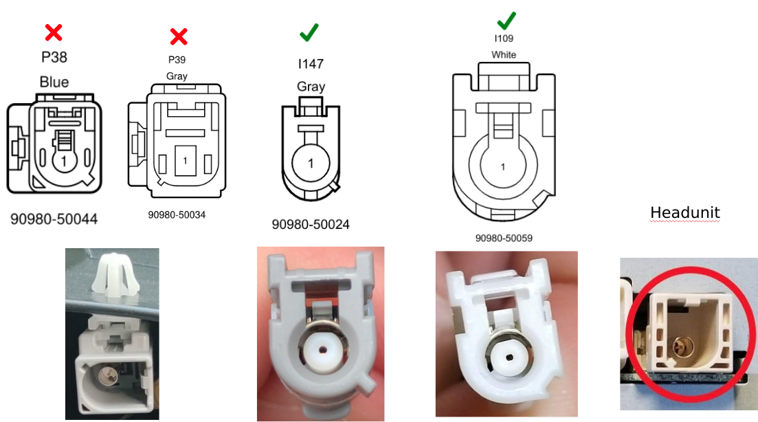

I have been investigating and it looks like it is not a standard one. I found that the male's P/N is 90980-50024. I have not found the female yet (it looks symetric to the 90980-50044. In the case of the male connector that goes directly to the headunit, it seems to be the: 90980-50059.
So, my progress so far:
