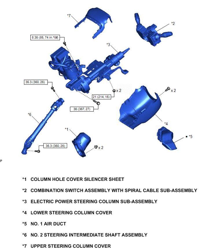

If the squeak has been isolated to the steering column, they may be proposing to replace item #3 or #6 in the image below, rather than the rack & pinion.

The intermediate shaft universal joints (#8 in the attached image), power steering worm gear (shaft of the motor shown in box #3), and seal where the steering shaft passes through the floor (#10), all require grease to operate quietly. Some of your grease may have dried up due to infrequent use. Replacement parts include a tube of the recommended grease (circled in red).
Rather than pay a Dealer US$2000 - US$3000 for replacement parts you may not actually need, why not pay an independent mechanic ~US$100 to apply a fresh coating of grease to the moving parts and see if the squeak ceases?

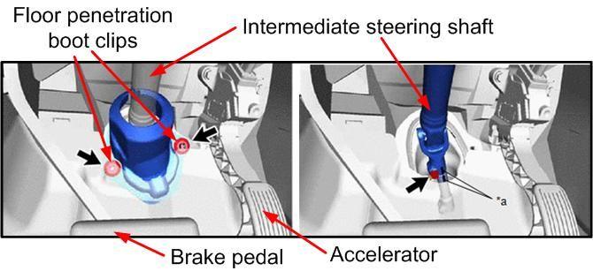

The way I would approach this is to first grease the parts that are easy to access, namely the boot that seals the opening in the floor for the shaft, and the lower intermediate shaft universal joint. Both are accessible without tools, and ordinary aerosol lithium grease should be suitable for these applications. A small container with a dispensing "straw" to direct the spray is best.
The images below show the locations of the boot and lower coupling. In the right image, the boot has been removed. Without actually removing the boot, it should be possible to spray some grease into the gap between the boot and shaft. The upper universal joint is not as readily accessible, though it might be possible to lube it blind with the dispenser straw.
