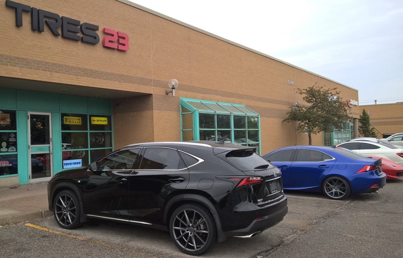

I had the VFS1s (22x9 +38) on 265/35/22 and personally found the fit to be spot on. They were flush at the front though just slightly tucked in at the rear.
A 10" wide rim on +35 offset will add an additional 15 mm poke clearly sticking out at the front though about flush at the rear. Consider a staggered setup 9" front, 10" rear though you'll have to check clearances on the inside rear suspension though I believe there is space.
Some pics here and below https://www.clublexus.com/forums/nx-...orts-park.html
Happy shopping!
