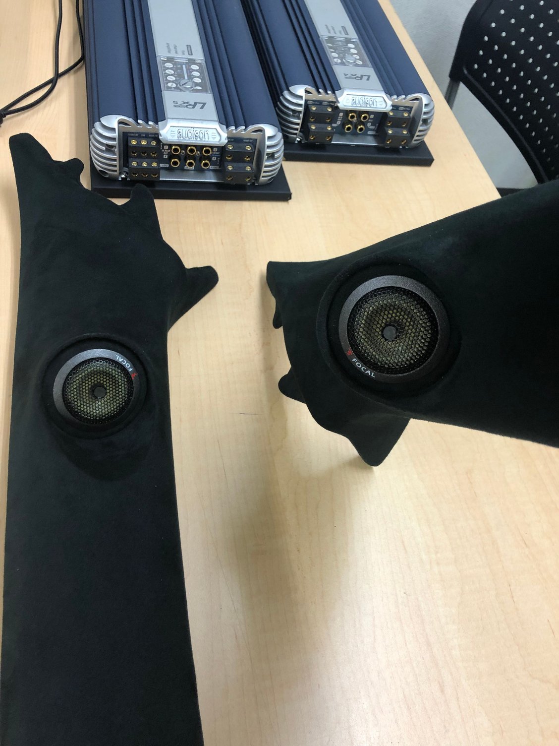

What is this solid piece that is sitting on top of the new speaker? Was it included with the speaker purchase? If not, does anyone have a link for this item?
Old Jul 5, 2019 | 05:32 PM
  #33
NipponCDN's Avatar
NipponCDN
Joined: Dec 2018
Posts: 44
From: Kanagawa
The speakers come like that from Focal, the ones I have have them too.

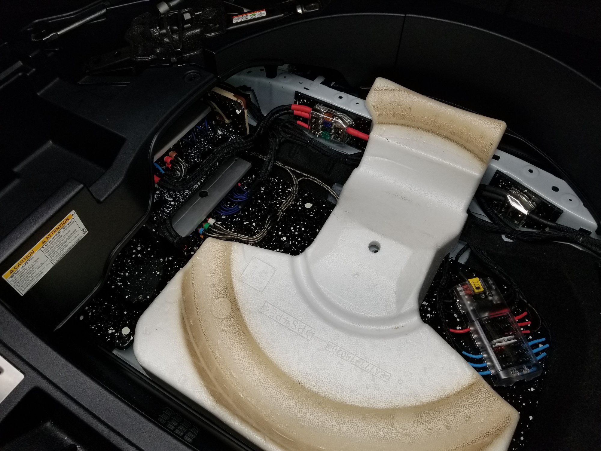

To update this post I've finally settled on this:
JL 4 Channel (Bridged) - Doors
JL 5 Channel (1,2) - Morell Tweeter (Dash)
(3,4) - Morell Midrange (Dash)
(5) - Sub
