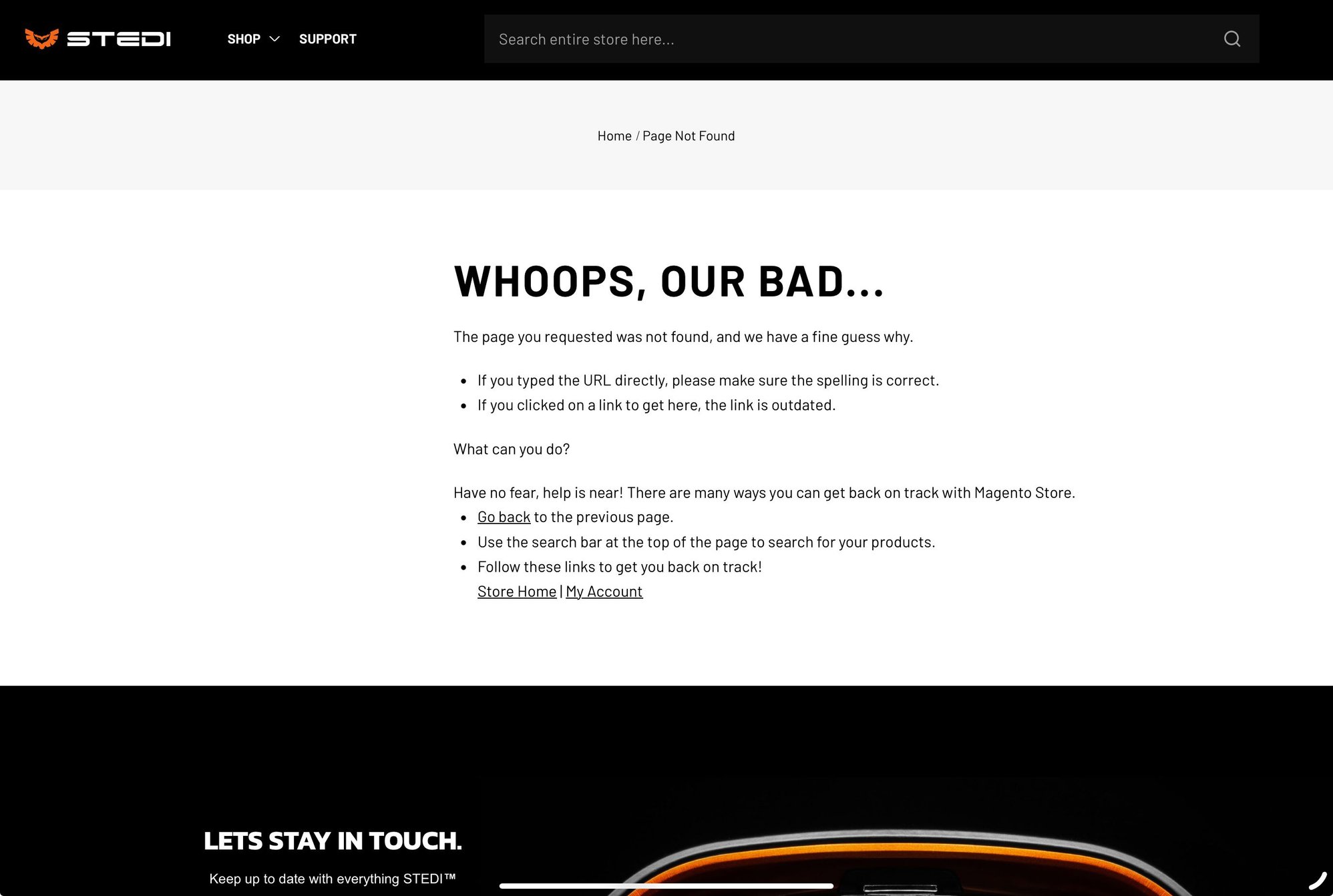

@bazzle01 — Can you please post another link as below is what I got when I clicked on yours.
I went to Store Home and tried to search to no avail and just decided to ask for a better link.
Thanks much

Club Lexus requires an income stream to provide this forum at no cost to users. When you click on a posted link, it is redirected through their paid advertisers so targeted ads can be inserted onscreen during your future logins. Here is the link that is being substituted for the one provided by bazzle01:
" https://redirect.viglink.com/?format...es%2Flexus%2Fn "
'vglink.com" evidently substituted a different URL in place of the requested Australia Stedi.com.au URL.
