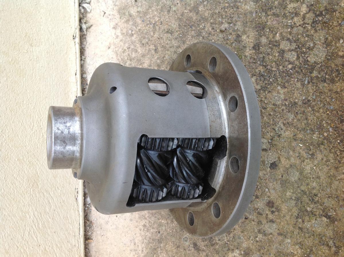

Hi guys I'm new to the site and thinking about getting a Lexus is so on here looking for advice and any common problems really, I owned a supra before and now looking for more space lol.
I have been clearing my garage and found this diff just wondered could any of you help telling me what it's off, I believe it's for a supra but not sure what model and I understand that Lexus owners use these diffs....
Codes on diff are. 0022-3703986. 34-0330. K4.

Looks like a T1 torsen diff. Count the gear ring holes. 12 holes = 6spd, 10 = auto.

Thanks, I think it's 10 holes but will will check in the garage later.

Just looked and it does have 10 holes so how much are these usually worth, any ideas?

$300-$500, not sure about europe tho
