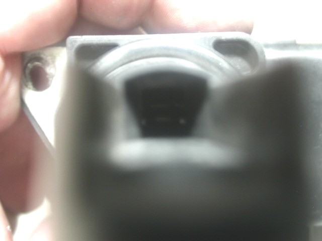

As far as the MAF sensor, you want to be sure you clean both the red diode and the two wires inside. the sensor shown here. I use CRC MAF sensor cleaner to clean them. They can get black quick.
Also, I don't discount an injector blockage issue (because then air>fuel). For that, I like to use Redline Fuel System Cleaner (costs about $8 USD). If you can't get it, just try a bottle of Techron (any auto parts place, even WalMart has it).
