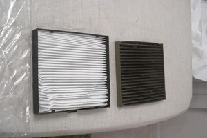

Called up Arlington Lexus for a parts quote on the interior cabin filter. 80 bucks. Then took a look at Sewell. 25 bucks. Found a solution for under 15 dollars that works MUCH better than the stock filter.
Take a 3m furnace filter, blue label. It's the highest rated one out there for allergens. Costs around 14 dollars before tax. Stock filter is made from fiberglass and allows mold, pollen, etc to go through. 3M filter is much finer and blocks better, probably down to less than 1 micron. Helps alot when you have allergies. Just take the 3M filter, cut it down to size and then stuff it into the stock filter housing. VERY easy and cost effective. You can make two filters out of the material, so each filter is effectively around 7.50 EACH.

White filter is 3M. Dark filter is expensive/crappy fiberglass that Lexus sells you.
