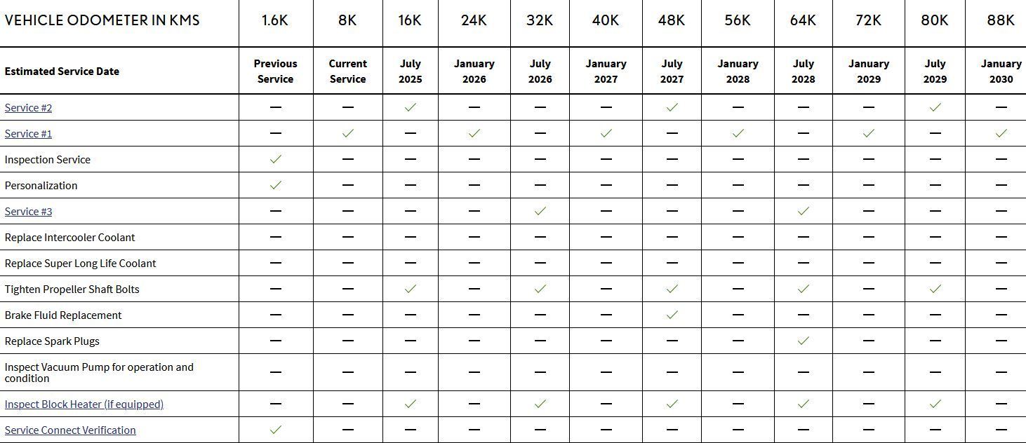

Wondering why Service #2 & Service #3 showing 16K apart? Is Lexus recommending oil change every 16K?
URL: https://www.lexus.ca/lexus/en/mainta...nance-schedule
Vehicle: RX350 - 2023
Vehicle Mileage 10,000 and Average km/mo.1333
Screenshot below:
Service #2 and Service #3 showing 16K apart

Yes, the factory oil change using recommended synthetic oil is 12 months or 10,000 miles under normal conditions. That is more of a mandate from government regulations than what is best for the engine. Governments have pushed to extend maintenance intervals in the interest of the green movement. The reality is most vehicles are not driven under normal conditions, and actually need to follow the severe usage especially in northern climates where the engine is not driven fully warmed up long enough. The reality is oil should be changed at 5,000 miles for engine longevity.
